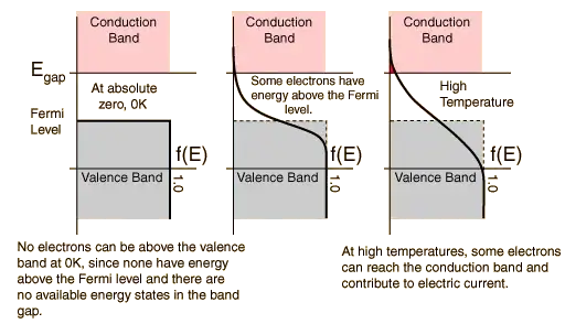

The highest occupied electron energy band is the valence band. If this band is full (all $k$ states are full), the material is an insulator as an applied electric field has no effect on the states of the electrons (bottom row on figure) - there's nowhere for electrons to go as all states are taken. However, if the valence band is partially filled, only a small amount of energy is required to shift some electrons into higher energy states (top row on figure). Thus the material is a conductor.

The first point to note is that in a periodic solid, you are essentially representing a solid with an infinite number of atoms, so you have a continuum of states, i.e. bands. The second point is that in a solid, the bands will be filled up to the top of the conduction band, each containing two electrons. In an electrical insulator, the electrons can be considered to be confined to their states, unless you give them enough energy (e.g. via photons or phonons) to cross the band gap from the valence band to the conduction band. In a metal, however, there is no band gap, so electrons can occupy conduction states without giving them a kick; instead, they occupy states up to the Fermi energy or Fermi level.
