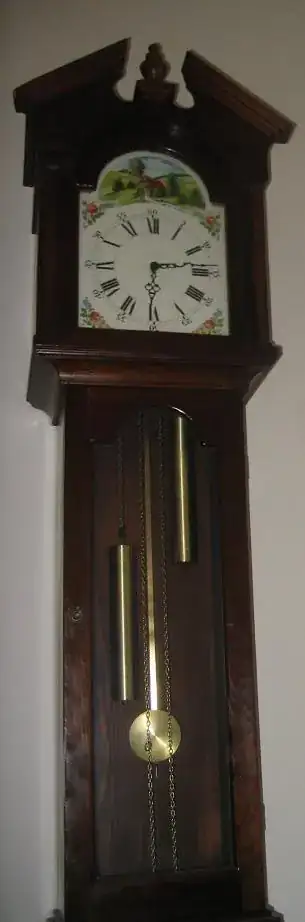

Grandfather Clocks
Longcase Clock, Wikimedia Commons
Grandfather Clocks have used powering weights since the 1660s. This was when they first gained their tall thin shape. The weights seen in the picture slowly descend as their stored energy is released. In order to add energy back into the system the weight needs to be wound back up.

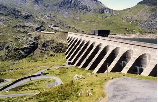

Ffestiniog Pumped Power Scheme
Ffestiniog Power Station
The Ffestiniog Power Station in Wales was opened in 1963 and was the UK's first large scale pumped hydroelectric energy storage system. The reservoir works in a very similar fasion to other grid storage solutions. When excess energy is produced (because coal power stations can't be shut down immmediatly for example) water is pumped from the lower reservoir back up to the higher one. When there is a surge in demand water flows in the reverse direction back down through turbines smoothing out any peak demand spikes making the whole grid more efficient.

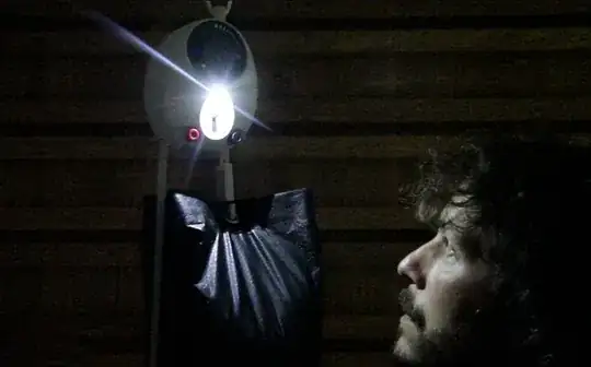

GravityLight
Gravity Light
Finally something very similar to the design in your question. Here is a product which recently went through an Indiegogo funding campaign. It's called GravityLight and works by the action of a falling weight to provide power to remote villages and others who live off-grid.

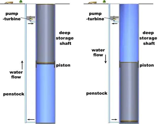

Other electricity storage technologies involving weights include those being developed by Gravitricity, Gravity Power (shown below), and Ground-Breaking Energy Storage (effectively cutting a large cylinder of earth and then raising it by pumping water underneath).
Gravity Power's underground energy storage system

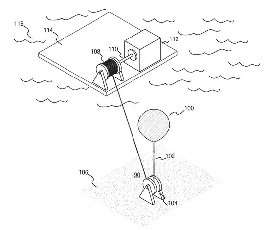

We can also use buoyancy as a means of storing energy. Research at the University of Windsor in Canada is ongoing into buoyancy energy storage, where a buoy is pulled down towards the seabed using a winch to charge the system, then allowed to rise back up to the surface of the sea in order to discharge the system and generate electricity. The winch is connected to a motor-generator in just the same way as the pump-turbine in a pumped storage plant is connected to a motor-generator, and can be located at the water surface (either on nearby land or on some kind of platform/barge) and connected to the base of the buoy via a pulley. Others are working on similar technology, including a company called Buoyant Energy.
Patent application 'Buoyancy energy storage and energy generation system', US 20100107627 A1
