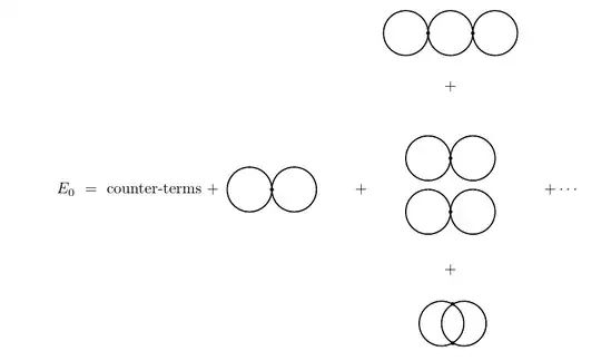

In the non-normal ordered theory, the vacuum bubbles are given by

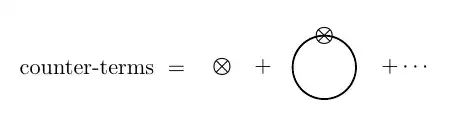

where "$\text{counter-terms}$" are the diagrams with counter-terms,
with value $-iD$ and $-i(A-1)p^2-i(B-1)$ respectively.

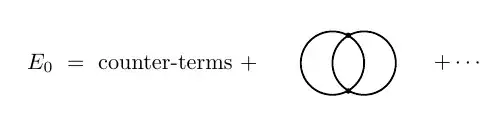

On the other hand, in the normal ordered theory, the vacuum diagrams are enter image description here
where "$\text{counter-term}$" is given by the same diagrams as before, but with value $-iD'$ and $-i(A-1)p^2-i(B'-1)$ respectively. If we now insist that $E_0\equiv 0$ to this order in perturbation theory, we get a certain (divergent) value for the coefficients $A,B',D'$, different than that of before.
The measurable object, $E_0$, has the same value in both approaches, but the coefficients do not. For example, $D'$ vanishes to first order in perturbation theory, but $D$ does not. Normal ordering has reduced the number of diagrams, and it has caused $D'\neq D$, but it has left the physics unaltered.
