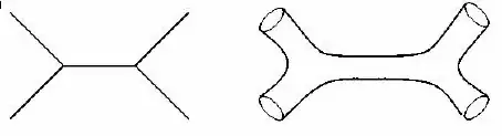

As an example, consider a Feynman diagram and its stringy analogue:
You can observe that the second picture doesn't have any "special points" in the interaction nodes. Interactions are made of... strings, just like strings themselves. In a theory of particles, we have to explicitly give expressions for interaction nodes. In string theory, these are given by the theory itself. String theory is already an interacting theory.
