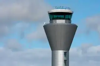

These same rules are also applied to air traffic control towers at airports:
Air traffic control tower
