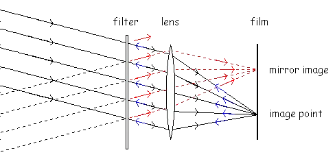

A previous question asked about the origin of the ghost-like image of the fluorescent bulb on this image,
which turns out to be something called a filter flare, of which there are more examples here and here, and which is explained in this page as being caused by a combination of two reflections, one on the camera's sensor and then one on a filter (or any other flat optical element), probably outwards from the lens:
Image source, © Paul van Walree
I am specifically confused about why the 'ghost' image appears inverted (i.e. rotated by 180°); since it has undergone two reflections (with each one causing an inversion), naively, it should appear in the same orientation as the original image. Doing some rough additional ray tracings on the diagram above I can roughly see that the mirror image should indeed be inverted, but I'm struggling to square that with the rough heuristics that each reflection should cause an inversion. So what gives?

Don't forget that reflection is not the only process that causes inversion. In this system of two reflectors and a positive lens between them there are 4 inversions before the ghost image is formed:
  1. focusing by the lens after initial crossing of the filter,
  2. reflection from the sensor,
  3. reflection from the filter
  4. focusing by the lens, which forms the ghost image on the sensor.
Between steps 2 and 3 there's no inversion, because the rays crossing the lens are defocused and intercepted by the filter before they form an image. It's the crossing of the rays that forms an image and results in inversion on focusing, and here it doesn't happen.
As 4 is an even number, the ghost image is upright—with respect to the object—and thus inverted with respect to the normal image.

It's only undergone one reflection: the film/sensor is not reflecting the image, but serving as a source of light for the optical system: look at the blue light rays which make this clear, and would be insane in terms of reflections). The ghost results from diffuse rather than specular reflection in other words: light scattering from the film/sensor. Additionally just look at the emulsion side of film: it is not shiny.
