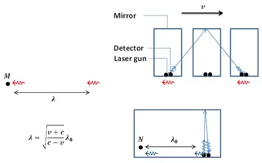

I think that when we consider light as a corpuscular phenomenon, the frequency of light depends on photon intervals and by changing the interval, the frequency (light's color) may alter. I have a reason for this claim:
If you consider Einstein's light clock consisting of a laser gun, a mirror and a detector from the viewpoint of the lab frame (M) where the light clock is set in motion, and if you (as observer N that is stationary with respect to the clock) assume the detector and the laser gun emit different photons (reds) towards the lab observer in a perpendicular direction to the path of light clock's main photons (light-blues) exactly at the time that each main photon is emitted towards and received from the mirror by the gun and detector respectively; you (this time, as the lab observer) will see that the interval of photons exactly complies with the relativistic Doppler effect.
