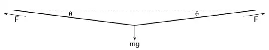

This is the boring answer that your physics teacher would give you :-)
The diagram above shows an idealised rope with all it's weight concentrated at the centre of the rope. If the rope mass is $m$ then the force downwards is just $mg$, where $g$ is the acceleration due to gravity.
Suppose you're pulling on the rope with force $F$, and the angle of sag is $\theta$. Because the rope is at an angle, when you pull on the rope you're pulling partly sideways and partly upwards, and the upwards part of your pull has to balance out the force $mg$. If the angle is $\theta$ then the component of your pull in the upwards direction is just:
$$ F_up = 2Fsin(\theta) $$
and because this balances the downwards force, $mg$, we get:
$$ 2Fsin(\theta) = mg $$
To find out how hard you need to pull we rearrange this to get:
$$ F = \frac{mg}{2sin(\theta)} $$
For very small angles, $\theta$, we use the approximation that $sin(\theta) \approx \theta$ and our equation becomes:
$$ F \approx \frac{mg}{2\theta} $$
and you can now see why it's impossible to pull the rope straight. As you pull the rope straighter $\theta$ becomes smaller, and for the rope to be completely straight $\theta$ would have to go to zero. But the force is proportional to 1/$\theta$ so to get the rope straight the force would have to be infinite.
For light ropes/strings the force $mg$ is very small, so we can eaily pull the string straight enough that by eye we can't see the sag. The sag is still there but it's to small to see. With a heavier rope $mg$ is greater and we simply can't put enough force in to make the sag too small to see.

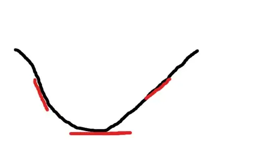

Let's start with the third point, which is mathematical, and then look at the physics of the situation. Take a look at this hill:
At the bottom, it's flat, which the middle red line shows. When you look on the sides away from the bottom, it's sloped. So if you want to be at the bottom, you need to be somewhere where small steps in any direction don't change your height. When you minimize a quantity, small deviations don't change it.

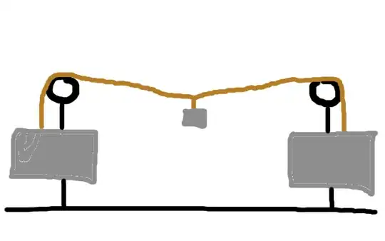

The black things are pulleys on supports. The brown thing is a rope. The grey things are weights. How heavy do the weights on the sides have to be to pull the rope straight?
The physics of a system like this is that the weights will try to fall as much as they can. Another way to say this is that at equilibrium (i.e. nothing is moving), systems go to their lowest possible energy state. (Or a local minimum, at least.)
There's a tradeoff here in terms of energy. You could pull the middle weight down further, lowering its energy, but that would yank the end weights up some, raising their energy. The system will have to find the right angle of the ropes so that the energy is minimized.
A straight string will never minimize the energy, though. It's the shortest possible path between the two supports. Since it's the shortest path, small deviations to that path don't change its length to first order. (That's the math point from the beginning of the answer.) That means that you could always lower the energy a little bit moving the middle weight down. The side weights don't go up because the distance between the middle weight and the posts isn't changing. Meanwhile, the middle weight is going lower down, so the total energy of the system goes down. That means the straight line is never the lowest energy state, and so can't be the equilibrium configuration.
You can't pull a piece of string perfectly straight - you just can't see the sag.
