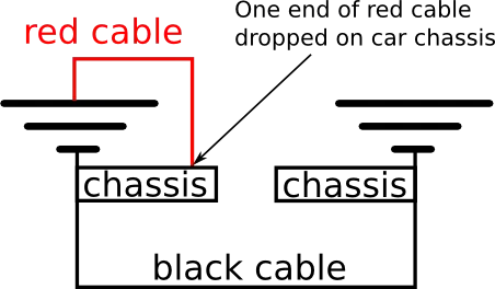

This question is a bit vague and not obviously entirely confined to physics. In order to make it a physics question, I'll focus on which order is better if the main concern is what happens to the circuit if we accidentally drop one of the cable's connectors.
Suppose we connect the black cable first, i.e. the one that goes on the "minus" terminal of the battery. Suppose also that the minus terminal is connected to the car chassis. Now suppose we connect the red cable to one of the batteries, and then accidentally drop the other end of the cable on somewhere on the car chassis. See the diagram.
Now we've shorted the battery, so lots of current will flow. There will probably be sparks etc. and if you leave the connection for too long (possible a very short amount of time) the battery will probably get hot and do I don't know what (i.e. catch fire/explode).
If you drop one of the connectors, it's easy for it to touch the chassis of the car because the chassis is big. On the other hand, dropping a connector onto the positive terminal of the battery is much more unlikely.
Therefore, if our main concern is what happens if we accidentally drop the cable, it's better to connect the red one first.
