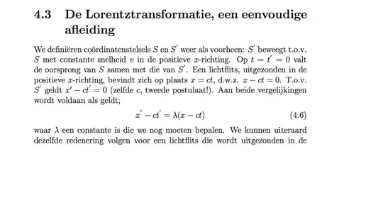

I have a question about the derivation of Lorentz transformations. My syllabus starts the proof in the following way: We have two inertial reference frames, S and S', that coincide at their origins at t=t'=0. S' is moving in the positive x-direction relative to S with velocity $v$. At t=0, an observer at the origin of S shines a light beam in the positive x-direction. We obtain $x-ct=x'-ct'$. This is still true if we consider a more general form, $x-ct=\lambda(x'-ct')$, where $\lambda$ is yet to be determined. So far, so good. Now they say that this observer simultaneously also shines a light beam in the negative x-direction, which yields to $x+ct=x'+ct'$. However, the syllabus now says that we would get a different general form $x+ct=\mu (x'+ct')$, instead of using the same $\lambda$ again.
How is this possible? If we found $\lambda$, then it should make sense that that same $\lambda$ would work in the negative direction. Could someone explain to me why we're working with two unknowns here?

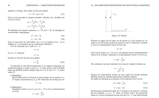

In case it helps, this is the proof as written in the syllabus (it's in Dutch). It's basically the "From physical principles" derivation found at the wikipedia page: https://en.wikipedia.org/wiki/Derivations_of_the_Lorentz_transformations
I'm fairly sure I can see what the issue is (I say this tentatively since I've used Google translate and the likeness of many of the unknown words to those of a language I do read for my day job (German)).
In a general setting, the two constants $\mu$ and $\lambda$ could indeed be different. This would be saying that the thought experiment would give different Lorentz factors depending on the direction of the relative motion, or, to put it another way that space is somehow not isotropic and behaves differently depending on the direction of the boost. We generally don't make such a complicated assumption in relativity.
However, the author specializes his/ her discussion in the paragraph beginning "Nu gebruiken we het relativiteitsprincipe ...", where it is stated that the length of a rod at rest in frame $S$ as seen from the relatively moving frame $S^\prime$ is the same length as it would be seen from frame $S$ if the rod were at rest with respect to $S^\prime$ instead.
This is effectively what forces $\mu = \lambda$ and asserts that the experiment works the same way whether the motion should be in the positive or negative direction - i.e. it asserts spatial isotropy.
