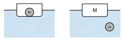

This diagram is my attempt to show the situation first when the rock is in the boat and secondly when you've chucked the rock over the side.
Boat
The mass of the boat of $M$ and the mass of the rock is $m$. The density of water is $\rho_w$ and the density of the rock is $\rho_r$. In the first case Archimedes' principle tells us that the volume of water displaced is:
$$ V_{disp1} = \frac{M + m}{\rho_w} $$
In the second case the volume of water displaced is:
$$ V_{disp2} = \frac{M}{\rho_w} + \frac{m}{\rho_r} $$
where the second term is just the volume of the rock. If we take the difference of these two we get:
$$ V_{disp1} - V_{disp2} = \frac{m}{\rho_w} - \frac{m}{\rho_r} $$
I think it's safe to assume that $\rho_r$ > $\rho_w$, i.e. the rock sinks in water, and in that case $ V_{disp1} - V_{disp2}$ is positive i.e. more water is displaced when the rock is in the boat, so the water level falls when you chuck the rock overboard.
