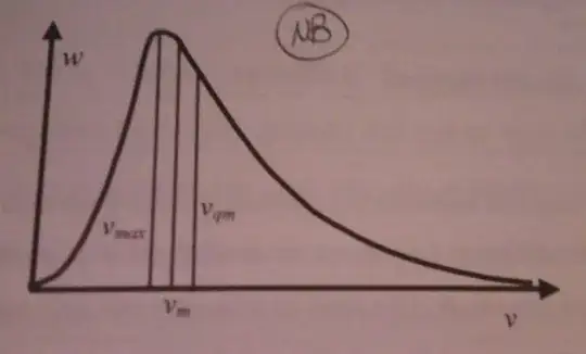

The answer to your question comes from Maxwell distribution of speed of the hydrogen molecules. from F. Ciccacci, "Fondamenti di Fisica Atomica e Quantistica" If you take a look at this graph, about the speed of a particle $v$ and the probability of that speed $w$, you can see that there is a non-zero probability that the speed of a certain molecule is greater than the root mean square speed $v_{\mathrm{qm}} $ of that distribution.
In particular, you can calculate the probability that the speed of a certain molecule is greater than the escape velocity of Earth $v_{\mathrm{esc}} = 11000\,\mathrm{m/s}$. Under the hypothesis of ideal gas, this probability is: $$\mathcal{P} = \int_{v_{\mathrm{esc}}}^{\infty} w(v) dv $$ defining the probability density function: $$ w(v) = 4 \pi \left( \frac{m}{2 \pi k_{\mathrm{B}} T}\right)^{3/2} e^{-\frac{mv^2}{2 k_{\mathrm{B}} T}} v^2 $$ where $m$ is the mass of the hydrogen molecule, $k_{\mathrm{B}}$ is the Boltzman constant, $T$ is the absolute temperature (in Kelvin) and $v$ the speed.
By doing this calculation (please let me use other values I have already calculated, at this point it should be easy to apply that formula for every value) at a temperature $T=270\,\mathrm{K}$ and with a mass $m_{H_2} = 2 \cdot 1.67 \times 10^{-27}\,\mathrm{kg}$, we get that the root mean square speed is $v_{\mathrm{qm}}=1830\,\mathrm{m/s}$. On the other hand, the probability that a particle has a speed six times greater than this value (it is approximately the escape velocity of Earth) is $2 \times 10^{-9}$. This value is small, but not negligible; in a long enough time, every molecule of hydrogen will escape from Earth's atmosphere.

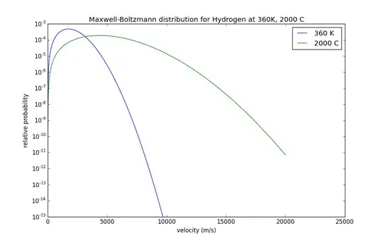

Note - if you plot the above on a semilog scale you can see just how small the probability of the high velocities is - and then you remember that the upper atmosphere (above 100 km or so) is actually significantly hotter than the air closer to the surface - under certain conditions, the upper part of the thermosphere can reach temperatures over 2000 C during the day. At that temperature, the probability of hydrogen escaping increases very significantly. This is illustrated in this plot:
Those hot hydrogen molecules (and atoms) high up in the outermost layers of the atmosphere have a really good chance of escaping...

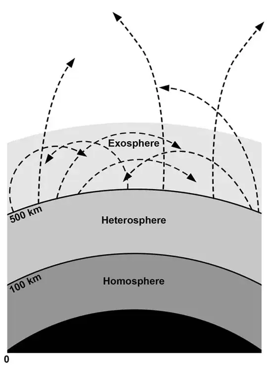

The other answers are correct in terms of the principal reason that lighter molecules are much more likely to escape the atmosphere. However, it seems that the premise of the question (and perhaps also of some of the answers and comments) is based on an incorrect model of atmospheric escape.
Molecules from most parts of the atmosphere would never escape regardless of velocity.
The picture below is taken from this document (recommended reading) and illustrates that escape is basically only possible for molecules above 500 km (the exosphere). Molecules below that will (most likely) collide with other molecules before escaping.
Exosphere

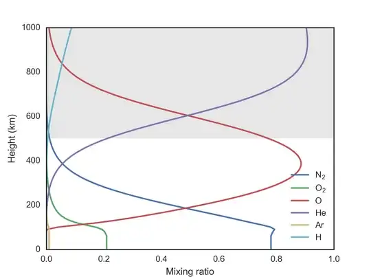

The figure below shows the mixing ratios for the main components between 0 and 1000 km based on data taken from NRLMSISE-00. The exosphere is shaded in grey. As you can see, the most abundant molecules in the exosphere are atomic oxygen, helium and hydrogen. Hence, it is kind of a moot point to discuss escape velocities of molecular hydrogen and oxygen. Of course, the mass ratio happens to be the same since they are both diatomic molecules (but note that a large part of the atomic hydrogen in the exosphere originated from water in the lower atmosphere rather than from molecular hydrogen).

It is also very hot in the exosphere (~1000 K) so making calculations for surface temperatures is also technically wrong (though again, it may happen to give the same qualitative result when comparing two species).
Yes, lighter molecules (or atoms) are much more likely to escape the atmosphere. The by far biggest reason for this is that they are much more likely to reach escape velocity (see the other answers). But another contributing factor is that they are much more likely to reach the upper layers of the atmosphere where they can escape because of gravitational stratification, which starts already in the heterosphere. However, most molecular species will be photolyzed into their atomic constituents by UV radiation before they reach altitudes high enough to escape, so it is really the mass of the atoms that matter. Another factor that is very important for which species reach the top of the atmosphere is of course chemical processes in the atmosphere, but that is a whole different chapter.
