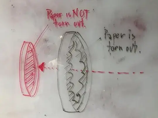

Imagine two hoops with identical size and with paper spanned in their holes. If those two hoops are approaching each other, and if only one of hoop is getting taller and wider (all are in direction perpendicular to their motion), then when they are crashing each other, only the taller and wider hoop would have its paper torn out.
Two Hoops Crashing Each Other
Now see this one (same) event happens from point of view Joe and Moe. If Joe sees Moe is moving with its hoop, and say Moe's hoop is the one getting taller and wider, then he would see Moe's hoop being crashed by his. But relativity principle dictates that if Joe sees Moe's hoop getting taller and wider than from Moe's point of view it must be Joe's hoop that is getting taller and wider. So from Moe's point of view, it would be Joe's hoop being crashed by his.
But one (same) event cannot have two outcomes. If what actually happens e.g. Moe's hoop is the one being crashed, then we will know that it is Moe that is moving, not Joe. This would violate the relativity principle because neither Joe nor Moe could decide who is actually moving.
