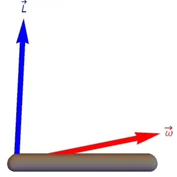

This bound is pretty much the best you can do, and it is easy to find examples where $\vec \omega$ and $\vec L$ are arbitrarily close to orthogonal. The simplest is a long, thin rod of length $L$ and radius $w$ that's rotating rapidly about an axis that is almost (but not quite) aligned with the rod:
Putting the rod along the $x$ axis, you get that the moment of inertia and angular velocity are given by $$ I= \begin{pmatrix} \frac12 Mw^2 & 0 & 0 \\ 0 & \frac13 ML^2 & 0\\ 0 & 0 & \frac13 ML^2 \end{pmatrix} \quad\text{and}\quad \vec \omega= \begin{pmatrix} \Omega \\ \delta \\ 0 \end{pmatrix}, $$ respectively, and that gives you $$ \vec L= \begin{pmatrix} \frac12 Mw^2\Omega \\ \frac13 ML^2\delta \\ 0 \end{pmatrix} $$ for the angular momentum, $$ \vec\omega\cdot \vec L = \frac12 Mw^2\Omega^2 + \frac13 ML^2\delta^2 $$ for the inner product, and $$ \cos(\theta) = \frac{\vec\omega\cdot \vec L}{L\omega} = \frac{ \frac12 w^2\Omega^2 + \frac13 L^2\delta^2 }{ \sqrt{\frac14 w^4\Omega^2 +\frac19 L^4\delta^2} \sqrt{\Omega^2+\delta^2} } \approx \frac{ 3 w^2/L^2 + 2 \delta^2/\Omega^2 }{ \sqrt{9 w^4/L^4 +4 \delta^2/\Omega^2} } $$ for the angle. Fixing the rod parameters at $w\ll L$, and then choosing an angular velocity with $\Omega\gg \delta$ and such that $$ \frac wL \ll \frac \delta\Omega $$ (i.e. the rod is much thinner than the spin axis is close to the rod axis), the cosine approximates to $$ \cos(\theta) \approx \frac{\delta}{\Omega} +\frac{3\,w^2/L^2}{2\,\delta/\Omega} , $$ which can be made arbitrarily small, with the angle $$ \theta \approx \frac \pi2 -\left(\frac{\delta}{\Omega} + \frac{3\,w^2/L^2}{2\,\delta/\Omega}\right) $$ arbitrarily close to 90°.
More geometrically, spinning a thin rod about its axis gives an angular momentum component along this axis which is very small, and any misalignment will give angular momentum describing rotation about the axis of misalignment which, if the rod is thin and long enough, can dwarf the angular momentum from the spinning itself.
