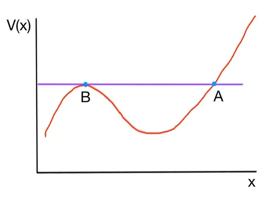

Liouville's theorem says that the flow in phase space is like an incompressible fluid. One implication of this is that if two systems start at different points in phase space their phase-space trajectories cannot merge. But for a potential with an unstable equilibrium, I think I've found a counterexample.
Consider the potential below (excuse bad graphic design skills). Potential with unstable equilibrium
A particle starting at rest at point A, $(q,p) = (x_A,0)$ at $t = 0$, would accelerate down the potential towards the left. Because it has the amount of energy indicated by the purple line, it would come to rest at the local maximum B at $t = T$, an unstable equilibrium $(q,p) = (x_B,0)$. However any particle started at rest at the top of the local maximum B at $t = 0$ would also stay that way forever, including up to $t = T$. Thus there appears to be two trajectories that merge together in violation of Liouville's thorem.
The fact that trajectories cannot merge (intersect) in the space of phased has nothing to do with the Liouville theorem, but it is a consequence of the fact that the Hamilton equations are of the first order (and the Hamiltonian us Lipschitz continuous). Keeping the first order of the equations and changing their form arbitrarily would make false the Liouville theorem, but the trajectories would not merge (or intersect) however.
Secondly, your example is misleading since you are looking at the projection of the trajectories onto the 1D configuration space instead of studying them in the 2D space of phases (where the Liouville theorem holds en passant). If you stay in the space of phases, you see that the solutions of the Hamilton equations you consider do not intersect. One is just a point (with $p=0$ and $x$ coinciding with the tip B of the potential) and the other is, a trajectory (closed under some conditions) around that state. When the motion passes through B in the variable $x$, there $p\neq 0$ so that the trajectories do not intersect. It apoarently happens only in rhe configuration space.
I am not sure this is entirely true. If you look at Equation 7 above, you will see the general form has phase space compressibility built into it.
Contrary to what many may think, the commonly expressed form of Liouville's theorem is a very specific case where none of the examples I listed above are present thus preserving an incompressible phase space.
For instance, look at the Boltzmann equation with the irreversible collision operator on the right-hand side. That equation presents a situation where $\tfrac{ d f }{ dt } \neq 0$, thus violating the simplified form of Liouville's thorem.

A few comments on the question you are asking:
  • The Liouville equation describes not a single particle, but an ensemble of states that evolve according to the laws of mechanics. The Liouville equation says that the entropy of the system stays constant at all times, which is to say that this equation describes isentropic processes and nothing else. The approach to equilibrium is accompanied by entropy increase, something that the Liouville equation cannot handle.
  • The statement that "two systems start at different points in phase space their phase-space trajectories cannot merge" is correct, but it is not a consequence of the Liouville equation. It follows from the fact that the differential equations of motion have a unique solution for given initial condition. Merging would imply that two different initial conditions produce the same state at some later time, which is not possible.
  • Your example does not violate the uniqueness of trajectories. To violate it you need to find two different trajectories in the same potential, with both trajectories starting at $A$ and both ending at $B$.

-1
Simply, Liouville's theorem implicates that the two particles can not take the same state at t=T because their state trajectories behave as currents in incomprisible fluid. Physically, when the first particle come to B, it will push the second particle and throw it to the left side.
