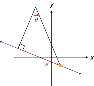

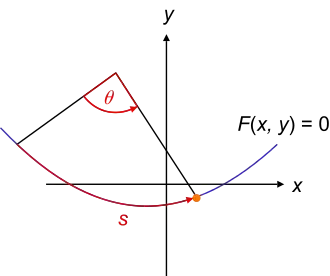

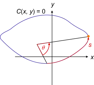

In the three pictures below:
Source: Generalised Cordinates
These are curves in 2 D space. We can "get away" with illustrating the path utilising one degree of freedom, (one generalised curve) in each of the cases, since the normal cartesian $x$ and $y$ curves are related to each other and can be parameterized by either an arc length or an angle.

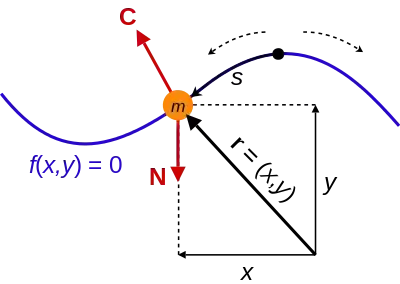

An example in 2 D.
Source: Bead on a Wire - Wikipedia
Assume a bead has the freedom to move along a frictionless wire. The shape of the wire automatically imposes a constraint on the movement in space of the bead. We can rephrase this mechanical constraint in terms of a reaction force  C on the bead. Obviously, precisely how we twist and turn the wire in 2 dimensions can lead to elaborate motions of the bead, which may not be easy to mathematically formulate. In the picture above, N represents gravity, which is (the sole) non-constraining force in this 2 D system.
The use of generalised coordinates is based on a careful choice of which of the coordinates should be chosen to be parameterised, if the physical situation allows for this. Thus two variables can be effectively reduced to one when analysing the motion of the bead.
We can express the constraint as $f(r) = 0$, where, at any point in time the position of the bead can be described by $r = (x(s), y(s))$, in this case the arc length $s$ is a parameter, as it is in one of the illustrations at the top of the page.
If we introduce distortions in the path of the bead, that is we bend the wire (within the 2 dimensional space), we end up with an expression:
$${\displaystyle f(\mathbf {r} ,t)=0\,,\quad \mathbf {r} =(x(s,t),y(s,t))}$$
and inevitably t has been introduced, both explicity in the equations regarding constraint and implicitly by means of the coordinates.
