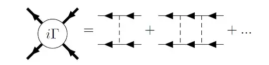

To illustrate these statements, let us consider the interaction $U(r_1-r_2,t_1-t_2)$ between two particles and solve the respective Bethe-Salpeter equation. First, consider the interaction $U(r_1-r_2)\delta(t_1-t_2)$, so that the interaction is instantaneous. The equation for the vertex function then is $$K_{12,34}=(2\pi)^8\delta_{p1p3}\delta_{p_2p_4}G_0^{(1)}(p_1)G_0^{(2)}(p_2)+G_0^{(1)}(p_1)G_0^{(2)}(p_2)G_0^{(1)}(p_3)G_0^{(2)}(p_4)i\Gamma_{p_1p_2p_3p_4}(2\pi)^4\delta_{p_1+p_2,p_3+p_4},$$ where $K_{12,34}$ is the two-particle Green function and upper indices denote particles. Then, you can write down the Bethe-Salpeter equation and extract the irreducible vertex part $\Gamma_0$. In case of instantaneous interaction, $U(\omega,k)=U(k)$. The first order diagram for the irreducible vertex part is zero, $$\int d\omega G_0^{(1)}(\epsilon_1-\omega)G_0^{(2)}(\epsilon_2-\omega)=0,$$ because poles of both Green functions, $$\omega_1=\epsilon_1-\frac{p_{1+}^2}{2m}+i\delta,\omega_1=\epsilon_2-\frac{p_{2-}^2}{2m}+i\delta$$ are in the upper half-plane. Then, you can show that all the diagrams with crossing lines go to zero. At second order, the irreducible vertex function is just $$\Gamma_0(p_1,p_2,p_1+q,p_2-q)=U(q).$$ Then, you can notice that the vertex function does not depend on frequency $\omega$. Therefore, all dependence on frequency comes from the Green functions, $$i\int\frac{d\omega}{2\pi}G_0^{(1)}(\epsilon_1-\omega)G_0^{(2)}(\epsilon+\omega)=\frac{1}{\epsilon_1+\epsilon_2-p_{1+}^2/2m_1-p_{2-}^2/2m+i0},$$ where $p_{i\pm}=p_i\pm k$. The denominator can be simplified by introducing CM energy and relative motion energy, $$\frac{p^2}{2m_1}+\frac{(p')^2}{2m_2}=\frac{P^2}{2M}+\frac{p_{\text{rel}}^2}{2\mu},P=p+p',p_{\text{rel}}=\frac{m_2p-m_1p'}{m_1+m_2}.$$ These manipulation give the following form of the Bethe-Salpeter equation, $$\boxed{\Gamma(k,k')=U(k-k')+\int\frac{d^3q}{(2\pi)^3}\frac{U(k-q)\Gamma(p,k')}{\Omega_0-q^2/(2\mu)+i0},}$$ where $\mu=m_1m_2/(m_1+m_2)$, $\Omega_0=\Omega-P^2/(2m)$, $M=m_1+m_2$, $\Omega=\omega_1+\omega_2=\omega_3+\omega_4$. So, you see that there is a bounded state with mass $M=2m$ with dispersion law $P^2/(2M)$.

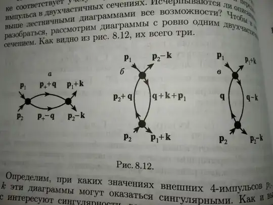

To emphasize mentioned facts, here are three diagrams (I am lazy to draw them, sorry) enter image description here
and the entire question is about the singularities of these diagrams. All the singularities comes from the poles of the Green functions in loops. Indeed, to perform integration over energy, you should use an appropriate contour, but external momenta can pinch this contour and the singularity appears. You can show that for the first diagram (from left to right) a singularity appears for $p_1+p_2\approx 0$, for the second and third, $p_2-p_1-k\approx 0$ and $k\approx 0$, respectively. The last diagram defines Fermi liquid theory, whereas the first diagram corresponds to the Cooper instability. The second diagram is "rare".

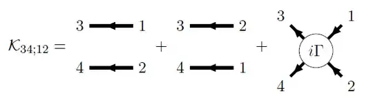

The case of vertex functions in condensed matter is more interesting than in QED. For QED, we define the vertex function via a four-point correlator, $$K_{ik,lm}=\langle T\psi_{i1}\psi_{k2}\bar{\psi}_{l3}\bar{\psi}_{m4}\rangle$$ and can easily consider this correlator in momentum representation. It is worth mentioning that one should also take into account all the loop corrections. From the structure of this correlator, you can extract the reducible part, enter image description here
which just gives the exact propagator of two particles without scattering. The last term is more interesting and represents the irreducible part. Finally, you can see that $$i\mathcal{M}_{fi}=\bar{u}_i(p_3)\bar{u}_k(p_4)\left[-ie\Gamma_{ik,lm}(p_3,p_4;p_1,p_2)\right]u_l(p_1)u_m(p_2),$$ where $i\mathcal{M}_{fi}$ is exactly the scattering amplitude. The next picture is the 4-point correlator for fermions, enter image description here

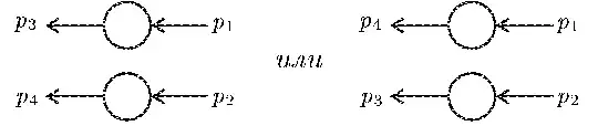

and in the non-crossing case (for instance, in superconductivity theory) the vertex function becomes enter image description here
