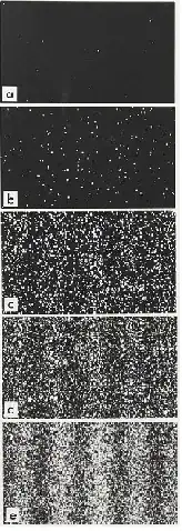

At the quantum mechanical level of the experiment, there is a time independent solution of "particle scattering off double slit". This solution defines the probability of finding the particle at an (x,y,z) at time t, where time is irrelevant in this case. This is because the boundary values of the specific problem are time independent. If the size of the slit changed with time, or the screen moved in the z direction in time, then the solution would have a time dependence.
The rate of incoming particles is irrelevant if the boundary conditions are time independent, so it is not a matter for discussion. The interference is at the probability level for the measurement, it is not the mass or the charge or .... that interferes, the individual particle comes through whole, the accumulation measures the probability distribution.
See these electrons building up the interference pattern in their probability distribution
![singlel dblslit
electron build up over time.
