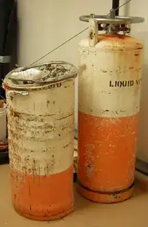

Only the experiment might tell us what the real pressure might be. Someone has even done it inadvertently (accident report):
This vessel exploded at a pressure of 1200 psi or 82 atm, so the pressure of 1L of liquid nitrogen heated up to room temperature should much higher than 82 atm. Considering that neither the ideal gas law nor its extension capture the required pressure range it is likely above 700 atm.
