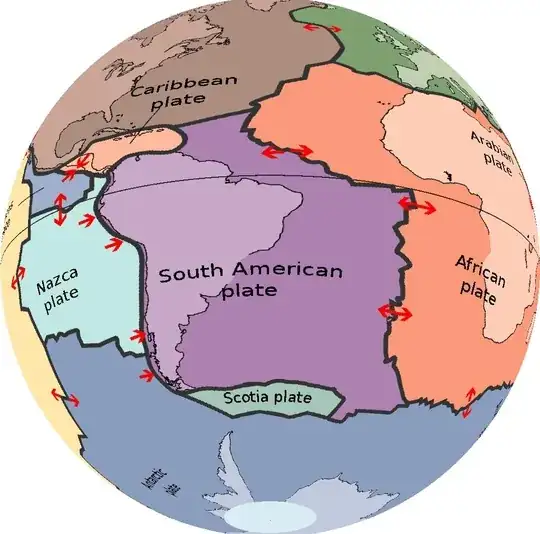

The Earth is the most broken planet in the Solar System.
I'm not saying that the cracks were created by explosions, nor collisions.
A possible explanation: the once intact crust had to crack in the process of cooling. The same explanation is valid to the cracked surface of Mars. The hot past climate of Mars is the only able to explain liquid water in it's surface 2Gyr ago.
enter image description here (image from Cartographers Guild - a forum created by and for map makers and aficionados)
IMO, Mars is a 'broken planet' (inspect google images to be sure) Mars is a 'broken planet' ?
