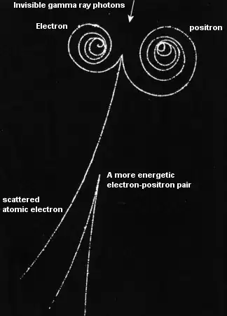

Here is the generation by a photon of an e+ e- pair in the field of an electron ( the long line)
e+e-e-
The energy-momentum vector of the incoming photon can be fitted by measurements and the mass of the incoming found zero within errors.
