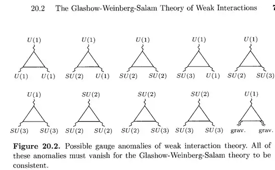

If no, is that the no-go reason due to (1) the fact of the gauge-gravity anomaly-cancelation in Standard model, such as a simple version of the Green–Schwarz mechanism for the Standard model? Or, is the no-go that due to the fact that the U(1) magnetic monopole is actually a topological charge, so it cannot be locally gauge-invariant, and it can not be created by a local operator? Or something else?
The known anomaly cancellation for the Standard model is described in Peskin and Schroeder Chap 20.2: enter image description here

The non-existence of monopoles in the Standard Model has nothing to do with anomalies or anomaly cancellation. The no-go theorem for topological monopoles in the standard (Glashow-Weinberg-Salam) theory of electroweak interaction is that four-dimensional 't Hooft-Polyakov monopoles of a gauge group $G$ broken to a subgroup $H$ require non-trivial $\pi_2(G/H)$ of the vacuum manifold $G/H$. If $G$ is simply and doubly connected, i.e. $\pi_1(G) = \pi_2(G) = 0$, then this is the same as requiring non-trivial $\pi_1(H)$ from the long exact sequence of homotopy groups applied to the fibration $H \to G \to G/H$. But in the GWS theory, the electromagnetic $H = \mathrm{U}(1)$ is usually dense in the torus $\mathrm{U}(1)\times\mathrm{U}(1)\subset \mathrm{SU}(2)\times\mathrm{U}(1)$ for generic (i.e. irrational) values of the Weinberg angle, cf. the answers by Qmechanic here and here, effectively becoming a non-compact $\mathrm{U}(1)$ - the embedding map is not continuous on the level of Lie groups.
