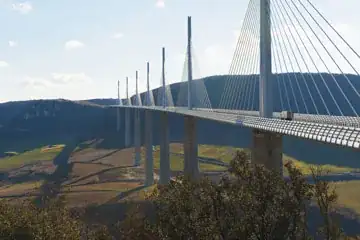

As I can see in the picture, there are so many pillars which are holding the bridge. This picture gave a question to me that what are these pillars doing below the bridge?? An appripriate answer could be "these are providing support to bridge".

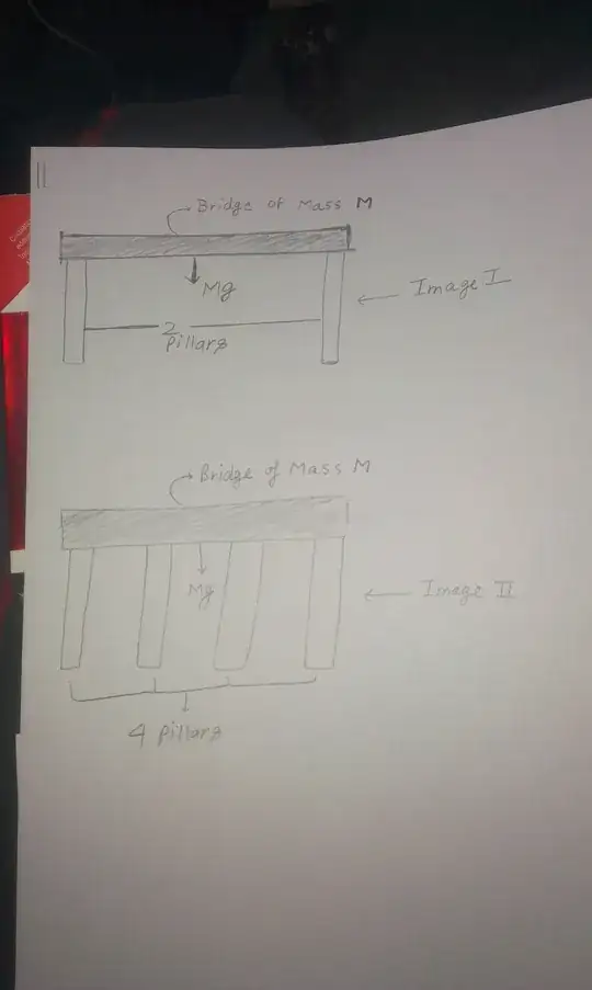

I tried to get the answer as follows: enter image description here
In the first image there are two pillars holding a bridge of mass $M$, since gravitaional force is acting downwards thus pillars are bearing a force of $\frac{1}{2}Mg$.
In the second image there are four pillars bearing a force of $\frac{1}{4}Mg$. I'm assuming that mass of bridge is uniformly distributed and each pillar is bearing an equal amount of the load.
Now the question is that since the pillars are bearing the force, so if we make strong enough pillars to bear a large force then there will be no need of so many pillars.
But that is not the case, we see a large number of pillars holding a bridge. What is wrong with the work I did? Shouldn't the number of pillars depend upon the strength of the pillars we make rather than the length of the bridge ??
I shall be thankful if you can provide more information about this topic.

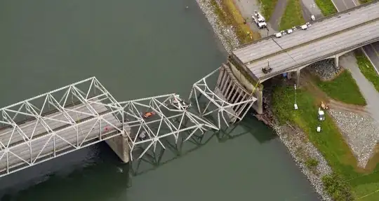

  1. Nothing is perfectly rigid
Your bridge is going to bend towards the center because of the moment exerted by its own weight and this is going to happen:
As you can see, the pillars are perfectly intact, but the bridge collapsed anyway.

There's another reason for these pillars that is yet to be mentioned in these answers.
If you look at the picture you can see that the pillars don't hold the bridge up on their own. They extend well above the bridge deck and have many cables coming off of them for suspension.
These wires provide some force to hold the bridge up away from the pillars, supporting the span.
As you can see from the image, as the bridge deck gets further from the pillar, the angle of the suspension cable becomes more horizontal.
If you want the cable to actually provide suspension force, it must be angled towards the vertical as much as possible. With more pillars, the maximum horizontal angle in the cables will decrease, as they are all close to a pillar. This means that closet pillars don't only provide more support against moments from below, but also from above.
Although the logic of multiple pillars can apply to every bridge, in suspension bridges this effect is especially important so that the cables can get the required vertical component of the tension.
