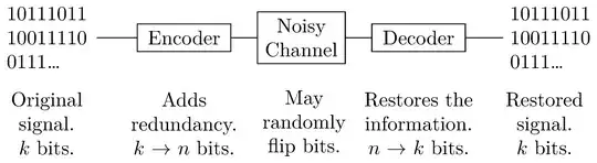

I know this is a very old question, and that Prof. Wen probably doesn't need this answer anymore. Also the answer provided by Steve is correct. However I was only able to understand the answer in hindsight, and I think I can give a simpler answer for what is code in toric code.
I think it's just in analogy with the classical problem of communication over a noisy channel. In this problem, we want to send $k$ bits over a noisy channel and still be able to retrieve the information in those $k$ bits on the other end of the channel. The solution to this problem is to encode the original signal of $k$ bits in $n$ bits, $n>k$. In another words, we add redundancy to the system such that when errors occur, we can still retrieve the original information stored in the those $k$ bits. The study of how efficient this encoding and then decoding process can be is called coding theory. The simplest classical code is maybe the repetition code, where for example $0 \rightarrow 000$ and $1 \rightarrow 111$. And then the decoding process would be a majority vote. enter image description here
The same problem is really amplified in the quantum world. In particular if we have any hope of performing quantum computations effectively we should have a way of correcting the errors as they happen for the qubits. The solution to this problem really follows the same spirit as in the classical case. That is, suppose we have $k$ qubits that we want to be able to retrieve the information stored in them after errors get introduced to the system. We add redundancy to the system by encoding these $k$ qubits into a bigger space of $n$ qubits. The details of how this can be done is somewhat different than in the classical case, however it shouldn't be surprising that such encoding of $k$ qubits into $n$ qubits is called a quantum code.
The toric code does exactly that. For example on a torus, it encodes 2 qubits as the fourfold ground state degenerate space of a physical model. The model provides the detail of such encoding, and hence it's a quantum code, called the toric code.
