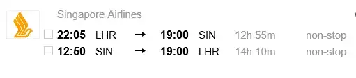

  1. Why is the journey time from London to Singapore less compared to Singapore to London? Is it because of Earth's rotation or because of wind?

Why is the journey time from London to Singapore less compared to Singapore to London? Is it because of Earth's rotation or because of wind. Why can't one just hover over earth and see earth actually rotating?
It's wind, see this answer: Airplane Travel Times. You take off with whatever speed the Earth's rotation has given you at that particular latitude. But the Earth's surface is also travelling at the same speed. So its only the speed that the plane achieves with its engines, and how local head winds or tail winds affect it, that is important. That's one reason, apart from the obvious ones, why rockets are not launched from the poles, they are launched from the equatorial regions. They use less propellent because they take advantage of the Earth's rotation, which is maximised at the equator.
You can't hover in the way you describe, because the air you are in is moving at the same speed as the Earth, apart from local winds. The Earth turns at 1670 kilometers/hour at the equator. At a latitude of 45 degrees, cos(45) = .707 and the speed is .707 x 1670 = 1180 kilometers/hr. If the air mass was stationary relative to that speed, we would notice it pretty quickly. Don't forget the effect of atmospheric air pressure in a vertical direction.
