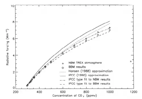

This nature of experiment has been done many times. Scientists have even carefully measured the radiative forcing value CO2. Here is a graph showing the radiative forcing obtained from experiments.
CO2 radiative forcing
This goes above and beyond demonstrating the greenhouse effect, and actually quantifies the effect through experiment, all of which are consistent with the desktop science projects that a small science class can do. I should qualify these statements with the fact that the radiative forcing is specific to the temperature of the surface, its emissivity profile, the other gases present, and the incoming spectrum. The parameters of a simple experiment will differ from greenhouse effect on a planetary scale, but the presence of the effect is the same for both. The absorption bands specific to the greenhouse gas (and in particular CO2) are well established by science. The increase in the effect due to increasing concentration of a greenhouse gas is due to effective broadening of absorption bands, which leads to definable predictions about how the radiative forcing changes, which this site has entertained questions about before. A correct description of the greenhouse effect may range in sophistication from saying it "blocks the outgoing radiation" to using detailed computer models of the radiative physics. Either way, the effect is very well proven by consistent theory and experiment and can make definable predictions with good accuracy. This part of climate science is, in no way, credibly contested. The contested part of climate science relevant to present-day politics is if the sum total impact of humans on climate will lead to higher surface temperature, which is outside the scope of this question.
