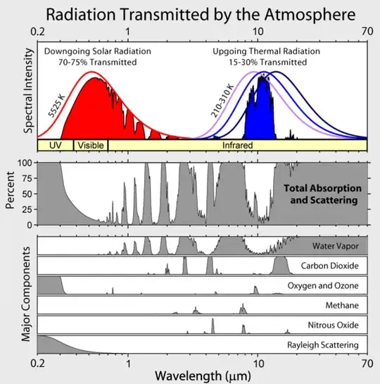

Looking at this rather popular (because of the climate debate) plot:
And, taking into account that the horizontal scale is logarithmic. I'd say that it is not that big of a coincidence.
