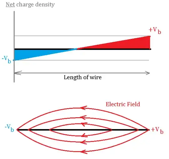

Just my opinion on why I think there must be a net electric field around a wire with steady current.
To have a steady current in a wire, there must be a voltage gradient through the wire (which is why I wouldn't prefer considering an infinite wire length with infinite resistance).
Imagine a straight wire simply connected to two identical batteries at each end. The current is steady and there is a voltage gradient. Voltage (relative to ground) is zero in a theoretical point in the middle of the wire and gradually rises in - and + values to the right and left ends of the wire.
Let's consider the half of the wire with negative voltage.
The voltage gradient should be caused by the free electrons compressed to a density more than they have in their rest state (which is equal the charge density of the positive ions/nuclei). This increased density is due to the resistance of the wire. You need to push electrons to overcome the resistance and by pushing, you squeeze them into higher density thus having more negative charges than their rest state in which all + and - charges cancel out to zero net electric field.
For the positive voltage half of the wire, it's the same except you dont compress but vacuum the electrons, rarifying them. The voltage gradient here is caused by the excess of positive ions. The density increases more and more to the end of the wire, eventually equaling the battery voltage there.
So, there are excess of negative and positive charges at each half. This should cause a net static dipole electric field around the wire. And how much current is produced by this voltage gradient? It depends on the resistivity and length of the wire.
A hydrodynamic analogy: You have a pump with a certain pressure supply. There will be a pressure gradient determined only by the pump pressure and pipe length. So you will have a little denser, compressed water than you have in the rest state. How much flow we get, depends on the hydrodynamic resistance on the water.
