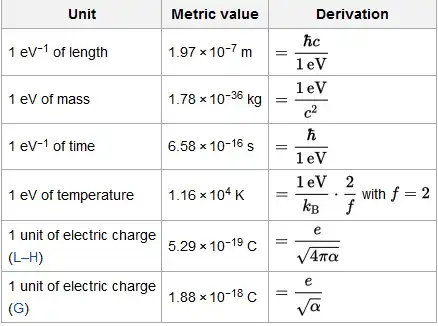

It so happens in the universe we find ourselves that three basic units can define all other units. They correspond to space time and mass, in the original unit systems, if one defines a unit for space (distances),mass, and time, everything else measured can be expressed in these units.
This led to the so called "natural units" where one chooses to set three basic constants, i.e. constants which are basic to the mathematical models developed to describe data/measurements, to 1 and simplify the maths.
In particle physics it is ħ = c = k_B = 1, k_B the Boltzmann constant
units
This sets the stage for the effect of changing units. Units can change as long as the three basic ones keep their relationship constant. In natural units the two numbers , permeability and permitivity of space would not change as long as the three basic units could be set to one, because the exact same theories would describe the data.
If this equality relationship were broken the theories would give different predictions and if broken too much life as we know it would not exist.
