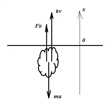

The moment the object is submerged, two forces act on it: Terminal depth
$F_B=V(\rho_{water}-\rho_{object})g$, the buoyancy force and a drag force $F_D$.
$F_D$ is usually modelled as $F_D=kv$ where $v$ is speed and $k$ a drag coefficient.
The equation of motion then is: $$ma=-F_B-F_D$$ $$ma=-F_B-kv$$ $$m\frac{dv}{dt}=-F_B-kv$$ $$-m\frac{dv}{F_B+kv}=dt$$ $$-m\int_{v_0}^{v(t)}\frac{dv}{F_B+kv}=\int_0^tdt$$ Where $v_0$ is the speed just after immersion. If the object falls from height $H$, then $\frac12 mv_0^2\approx mgH$. $$-\frac{m}{k}\ln\frac{kv(t)+F_B}{kv_0+F_B}=t$$ $$kv(t)+F_B=(kv_0+F_B)e^{-\frac{k}{m}t}$$ $$v(t)=\frac1k\Big((kv_0+F_B)e^{-\frac{k}{m}t}-F_B\Big)$$ $$\frac{dx(t)}{dt}=\frac1k\Big((kv_0+F_B)e^{-\frac{k}{m}t}-F_B\Big)\tag{1}$$ $$\int_0^{x(t)}dx(t)=\int_0^t\Big[\frac1k\Big((kv_0+F_B)e^{-\frac{k}{m}t}-F_B\Big)\Big]dt$$ $$x(t)=\frac1k\int_0^t\Big((kv_0+F_B)e^{-\frac{k}{m}t}-F_B\Big)dt$$ $$x(t)=\frac1k\Big[\int_0^t\Big((kv_0+F_B)e^{-\frac{k}{m}t}dt-\int_0^tF_Bdt\Big]$$ $$x(t)=\frac1k\Big[-\frac{m}{k}(kv_0+F_B)\big[e^{-\frac{k}{m}t}\big]_0^t-F_Bt\Big]$$ $$x(t)=-\frac{m}{k^2}(kv_0+F_B)(e^{-\frac{k}{m}t}-1)-\frac{F_Bt}{k}\tag{2}$$ At some point $v(t)$ becomes zero and the buoyancy then causes the object to reverse direction, so there is a minimum value for $x(t)$. We can find $t_{min}$ as follows: $$\frac{dx(t)}{dt}=\frac1k\Big((kv_0+F_B)e^{-\frac{k}{m}t}-F_B\Big)=0$$ $$e^{-\frac{k}{m}t}=\frac{F_B}{kv_0+F_B}\tag{3}$$ $$t_{min}=\frac{m}{k}\ln\frac{kv_0+F_B}{F_B}\tag{4}$$ $$e^{-\frac{k}{m}t}-1=-\frac{kv_0}{kv_0+F_B}\tag{5}$$ $$x_{min}=\frac{mv_0}{k(kv_0+F_B)}-\frac{mF_B}{k^2}\ln\frac{kv_0+F_B}{F_B}\tag{6}$$
$(6)$ represents the deepest an object would sink, before buoyancy starts making it move upwards again.
