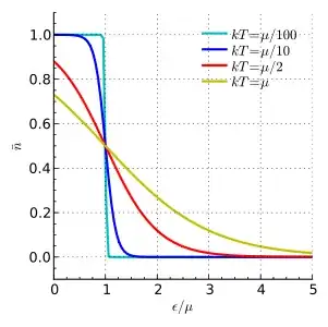

I would brush it off as a typo, but when I look at a graph of Fermi-Dirac distributions for different temperatures it does seem that they take on the form of an exponentially decaying function when the temperature is high:

Unless you are in the low temperature limit, then the F-D distribution should be written as $$ F(E) = [\exp (E-\mu)/kT +1]^{-1},$$ where $\mu$ is the chemical potential.
I think what you are missing is that the chemical potential is not a constant, it is temperature-dependent. At high temperatures then $\mu < 0$ and $\exp(-\mu/kT) \gg 1$. You could have a look at this answer to another question for an explanation of why that is.
Thus $$[\exp (E-\mu)/kT +1]^{-1} \simeq [\exp(-\mu/kT)\exp(E/kT)]^{-1} =\exp(\mu/kT)\exp(-E/kT) $$ which is the Boltzmann distribution and is $\ll 1$ for all $E$.
