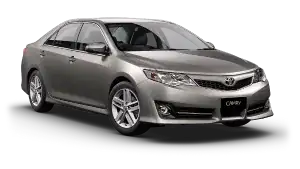

Say I have a Toyota Camry. What is the minimum volume I can crush this into?
