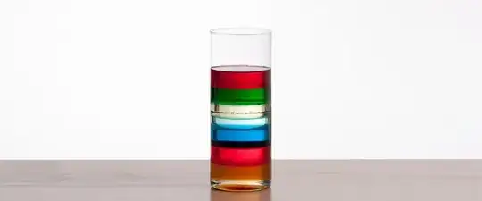

  1. If we had a jar of marbles or something else of different densities and shook it, the most dense ones would go to the bottom and the less dense ones to the top. enter image description here(Image Source)

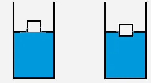

But for ice : what I am trying to understand is why doesn't the water (being denser than the ice) seek to reach the bottom, and the ice sit flat on top of it (as in the left image)? Instead, some part of the ice is submerged in the water (as in the right image), and some sits on top it.

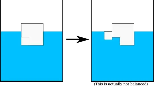

I think the real question you're asking here is: why do less-dense fluids completely stay above more dense fluids, whereas less-dense solids partly sink?
If the ice covered the same area as the water below, then it would sit completely on top of the water. That's the case in a completely ice-covered pond.
But because the ice does have a non-negligible weight, the ice-water surface has higher than atmospheric pressure – this is what supports the ice layer from sinking. However, if there's any gap in the ice cover, the excess pressure will push water up until its own hydrostatic pressure compensates it. In particular, if most of the surface in not covered with ice, then there will be a lot of water rising above the bottom of the ice. This is more sensibly described the other way around: the ice sinks some way into the water.
Now, that gives you a state which is not quite optimal, energetically: there are portions of water sitting higher than portions of ice. If you could swap these portions, you'd get a more stable state.
Optimising energy of a floating ice block
The limit of this process is a state where all ice is sitting above water. However, since the ice is solid, you can't really do this without cutting / breaking off pieces of ice.
In the case of two fluids of different density, it is however easily possible to move portions of the lighter material around, and because it's energetically favourable it will actually happen automatically.

The difference between the picture of the liquids all nicely layered on top of each other and an ice cube in water is that the liquids can change their shape to fit the shape of the container while the ice cannot. If the ice could change its shape and flow to fill the container, you would see exactly what your intuition predicts: the ice sits fully on top of the water. In fact, if you visualize a lake that has frozen over, that's exactly what you get! However, your ice cube cannot flow like that. So, instead, it follows Archimedes's principle, as others have suggested, and "displaces" an amount of water equal to its mass. Since it is less dense than water, that amount of displacement will lead the ice cube to rest partially submerged.
As for the marbles shaking to the top, that's slightly different. It's the same principle, just with a twist. In the case of the container of marbles being shaken, it's a stochastic process. The statistical expectation is that the average shake will cause the less-dense objects to rise to the top and more dense objects to sink. However, we rarely shake them enough to fully separate the marbles into distinct crisp layers. Compare this to liquids. The equivalent case for a liquid would be lots and lots of little marbles, and you're shaking them continuously really really fast. Naturally, we see more stratification in liquids than we do in solids, simply because of this.
Note: there is also a second effect in the case of the marbles. The above example occurs only if every object is of the same size. In the case of mixed media (such as a container of mixed nuts), this effect is overshadowed by another effect. Small objects can pile in underneath large ones, so in general the large ones (such as the macadamia nuts) rise to the top.
Even in this case, with an effect which is more pronounced than density, we don't see a perfect stratification of the mixed nuts. There's always a small number of them that are not in the "right place," such as a peanut that manages to get thrown on top of a sea of walnuts. So when you compare three cases, the stratified liquids, the ice on top of water, and the container of marbles, you actually don't see the stratified liquids and marbles "acting the same" and ice acting strange. You really see the liquids being most stratified, then ice on top of water, and the marbles actually provide the least stratification of the three examples. If your intuition tells you otherwise, that may suggest that your intuition is accounting for some of these random factors for you, and biasing your results.

I would say what is shown in your second image out of three, where the piece of ice is on top of the water, is statically impossible because the pressure on the water surface under ice is greater than the pressure on the water surface between the ice and the walls of the container, so water is squeezed up between the walls and the ice. On the other hand, if the ice fit tightly in the container, it could "float" on top of water.
