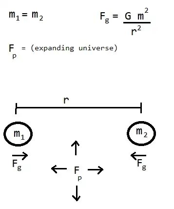

Anyways, imagine two objects in this hypothetical universe that have the same mass, say, 1 kg. At what distance apart should they be placed such that the expanding universe "moves" them apart at the same rate that gravitational forces would pull them together so that the net effect is they remain "stationary?" If the expanding universe can be thought of as a force, call it $ F_p $, then I think I want to find
$$ F_p + F_g = 0 $$
picture for clarification:
