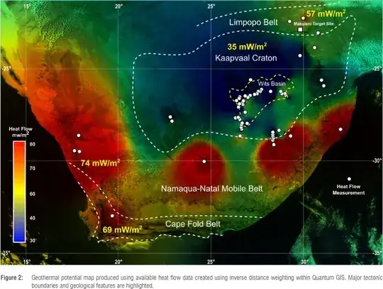

and makes it clear that there can be local variations. With that in mind even some very mild digging turns up this map of the geothermal heat flow in South Africa:
(Taken from S. Afr. J. Sci. 110 no. 3-4, p. 1 (2014).) This makes it clear that the Mponeng mine is right on top of a cold spot in the Wits basin.
The stated heat flows are not enough to reconstruct the thermal gradient (you need the thermal conductivity for that), and I'm not going to go on an expedition for fully trustworthy sources for that gradient. However, some more cursory digging unearthed this source, which looks reasonable (if not particularly scientific), and which claims that
mining at these depths is only feasible in South Africa’s Wits Basin due to a relatively low geothermal gradient (nine degrees Celcius/km) and the presence of gold reefs in hard competent country rocks.
This is enough of an agreement to call it a day. Backtracking a 9 °C/km gradient over 4 km gives a ~36 °C difference, and taking that away from the 66 °C (maximal!) rock temperature in the mine gives a ~30 °C average surface temperature. This is relatively high, but it is within a reasonable envelope, and there's plenty of leeway on the numbers (e.g. making the gradient 10 or 11 °C/km) to take away any glaring contradictions.

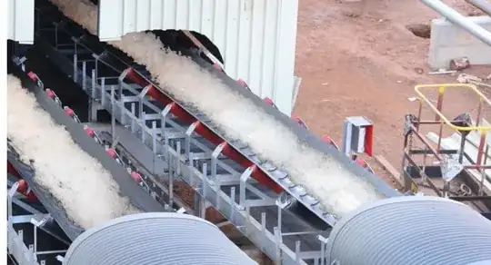

After doing some more research on this question I have determined, like the other answers, the reason that the miners do not boil to death is that they cool the mine actively. Originally this was done by using chilled service water and ice slurries, a method pioneered scientifically by Wagner (Wagner, H. The management of heat flow in deep mines. Geomechan. Tunn. 2011, 4, 157–163). In more recent years the depth of the mine has become such that it is economic to use hard ice. This is done by conveying hard ice into the bottom of the mine and pumping out the melt water. Here is a picture of the ice as it enters the mine:
hard ice cooling

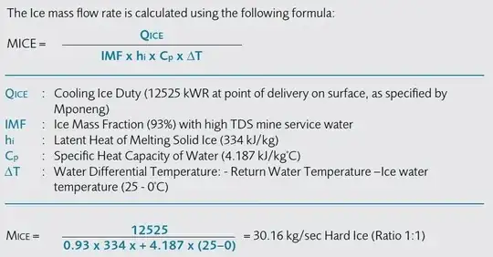

The amount of ice needed is computed in the following way:
ice mass flow
After the ice melts, the melt water at temperature 25 °C is pumped back to the surface. According to Howden, the company that provides the technology to cool the mine, the virgin rock temperature at the bottom of the mine is 55 °C and the ambient air must be maintained at a temperature of 28 °C or lower. It is important to realize that virgin rock temperatures are only one source of heat. Mining machinery engines, lighting systems and auto-compression of air all add more heat. Auto compression is the term used to describe the way air is compressed by its own weight as it descends into the mine. The heat flow into the mine is mitigated by using thick concrete-based insulation that provides a thermal barrier to the virgin rock. The mine is lined with this insulation, reducing the amount of cooling ice needed.
