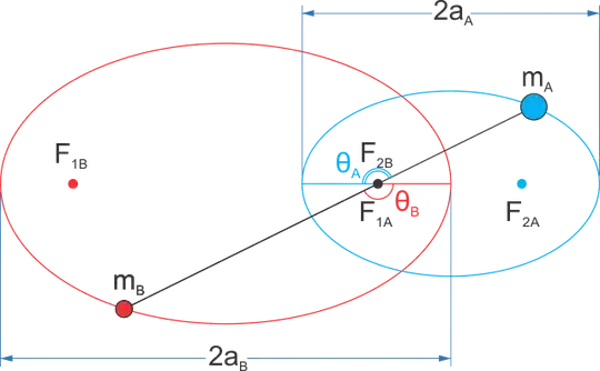

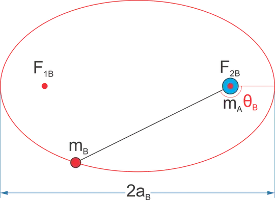

We all know that Kepler's third law for a system of two bodies which one of them have much greater mass than the the other is like this:
$\frac{{T_B}^2}{{a_B}^3}=\frac{4\pi ^2}{Gm_A}\;\;\;\;(m_A\gg m_B)$
But when the law applies for two bodies with comparable masses with the assumption that $T_A=T_B=T$ the equation should look like this:
$\frac{T^2}{(a_A+a_B)^3}=\frac{4\pi ^2}{G(m_A+m_B)}\;\;\;\;(m_A\sim m_B)$
Now here some questions arise:
  1. How can this relation be proved at first?($\frac{T^2}{(a_A+a_B)^3}=\frac{4\pi ^2}{G(m_A+m_B)}\;\;\;\;(m_A\sim m_B)$)
  2. How do we know that $T_A=T_B=T$?
  3. How do we know that $F_{2_B}\equiv F_{1_A}\equiv Center\:Of\:Mass$?
  4. If $e_A$ is the eccentricity of Orbit of mass A and $e_B$ is the eccentricity of Orbit of mass B, How do we know that $e_A=e_B$?
And also something offtopic: How do we know that the relative path of one mass respect to the other one is also an ellipse with an eccentricity also equal to $e=e_A=e_B$

For the other two it might be easier if I would first answer your first question. If we represent the distance between $m_A$ and the center of mass as $r_A$ and similar the distance between $m_B$ and the center of mass as $r_B$. By definition of the center of mass, it should always be in between and inline with $m_A$ and $m_B$, and
$$ m_A\,r_A=m_B\,r_B. \tag{1} $$
The gravitational force from $m_B$ on $m_A$ could also be caused by another fictional mass fixed at the center of mass. The mass of this fictional object, denoted with $\hat{m}_B$, can be found, such that it would always exert the same force as $m_B$,
$$ \frac{G\,m_B}{(r_A+r_B)^2} = \frac{G\,\hat{m}_B}{r_A^2}, \tag{2} $$
using equation $(1)$ then $r_B$ can be expressed in $r_A$, $m_A$ and $m_B$,
$$ \frac{G\,m_B}{r_A^2\left(1+\frac{m_A}{m_B}\right)^2} = \frac{G\,\hat{m}_B}{r_A^2}, \tag{3} $$
$$ \hat{m}_B = \frac{m_B^3}{(m_A + m_B)^2}. \tag{4} $$
In a similar way you could also do this for $m_B$ by replacing $m_A$ with $\hat{m}_A$ fixed at the center of mass,
$$ \hat{m}_A = \frac{m_A^3}{(m_A + m_B)^2}. \tag{5} $$
Using these masses you can now use your initial expression for the orbital period,
$$ T_A = 2\pi\sqrt{\frac{a_A^3}{G\,\hat{m}_B}} = 2\pi\sqrt{\frac{a_A^3\,(m_A + m_B)^2}{G\,m_B^3}}, \tag{6} $$
$$ T_B = 2\pi\sqrt{\frac{a_B^3}{G\,\hat{m}_A}} = 2\pi\sqrt{\frac{a_B^3\,(m_A + m_B)^2}{G\,m_A^3}}. \tag{7} $$
Equation $(1)$ should also hold for the semi-major axes as well, so for the expression for $T_B$ could also be written as,
$$ T_B = 2\pi\sqrt{\frac{\left(a_A\frac{m_A}{m_B}\right)^3\,(m_A + m_B)^2}{G\,m_A^3}} = 2\pi\sqrt{\frac{a_A^3\,(m_A + m_B)^2}{G\,m_B^3}}, \tag{8} $$
which is the same as the expression for $T_A$ in equation $(6)$. Calling this expression $T$ and rewriting it to a form similar as stated in your question yields,
$$ \frac{T^2\,m_B^3}{a_A^3\,(m_A + m_B)^3} = \frac{4\pi^2}{G\,(m_A + m_B)}. \tag{9} $$
By again applying equation $(1)$ to the semi-major axes, then the left hand side of equation $(9)$ can be written as,
$$ \frac{T^2\,m_B^3}{a_A^3\,(m_A + m_B)^3} = \frac{T^2}{\left(a_A\,\left(\frac{m_A}{m_B} + 1\right)\right)^3} = \frac{T^2}{\left(a_B + a_A\right)^3}, \tag{10} $$
which is indeed the relation that you where after.
Since I already showed that relative to $m_A$ you could replace $m_B$ with $\hat{m}_B$ fixed at the center of mass. Because $\hat{m}_B$ is fixed, then it should also be a focal point of the orbit of $m_A$. Similarly it can be shown that the center of mass should be a focal point of the orbit of $m_B$.
Now assuming that the resulting orbit of $m_A$ looks like,
$$ r_A = \frac{a_A\,(1 - e_A)^2}{1 + e_A\,\cos\theta}, \tag{11} $$
then by using equation $(1)$ an expression for $r_B$ can be found to be,
$$ r_B = \frac{m_A}{m_B} \frac{a_B\frac{m_B}{m_A}\,(1 - e_A)^2}{1 + e_A\,\cos\theta} = \frac{a_B\,(1 - e_A)^2}{1 + e_A\,\cos\theta}. \tag{12} $$
So the eccentricities of both orbits should also be the same, only the point from where you measure $\theta$ should be rotated 180°.
