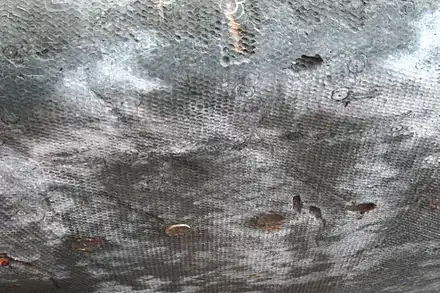

Apollo 12 capsule's ablative heat shield (after use) on display at the Virginia Air and Space Center.
Image Source: Wikipedia Heat Shield Ablation
The ablated heat shield of an Apollo command module
With a space probe, normally it would be impossible to withstand this level of heat, so an ablation heat shield is used, which carries energy away from the spacecraft by, "burning" away like a meteor, but with more control over the ablation of the spacecraft surface by pitching the craft at a specified angle and by creating the ablation shield from composite materials that burn slowly.
