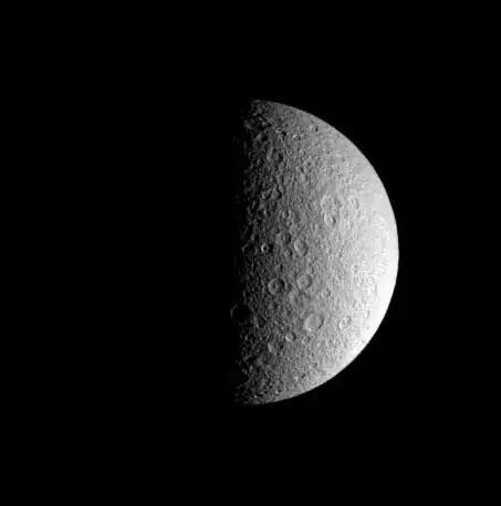

Here's Cassini image of Saturn's moon, Rhea:
Cassini image of Saturn's moon, Rhea [via http://photojournal.jpl.nasa.gov/catalog/PIA07606]

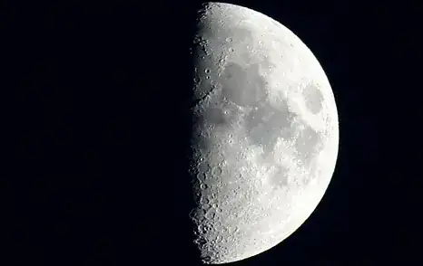

Here's our own moon:
Half moon [via https://www.emaze.com/@ALRIZCWQ/David-Moon]
Notice how the former, much further away from the sun, has a far slower cutoff?
I believe it's because the very brightest point is far dimmer sunlight: it's about ten times further from the sun, which means, by the inverse square law, that it's about 100 times dimmer out there.
So I think it's just that our vision is saturated. If we take that lunar picture and desaturate it by increasing contrast by 65% while reducing brightness by 70%, we get...
Half moon desaturated
Which is much more like the first, I feel, though it's clear that a lot of the levels have been lost.

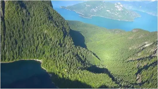

The sun illuminates every particle of the moon that it "sees" with the same intensity. During a full moon we see each particle of the moon from the same angle and therefore we see each particle eliminated with the same intensity. The relative macro slope of the moon's surface has no influence on the brightness of each particle.
The phenomenon you describe is due to Heiligenschein.
Heiligenschein or “holy glow”, is a phenomenon frequently seen in aerial photography. https://en.wikipedia.org/wiki/Heiligenschein A bright spot is seen in the antisolar direction. It can be due to “cat’s eye” reflection from dew drops (obviously not a factor on the Moon) but is also seen on any rough surface such as a forest.
In the photograph below you may see (with the eye of faith) the aircraft’s shadow in the center of the “hot spot”. This is a common phenomenon seen from small aircraft flying over forests.
The regolith on the Moon’s surface produces strong Heiligenschein. This is why a full moon is much brighter than it “should be” if its surface was matte. (A full moon is much more than twice as bright as a half moon). This effect was noticed long before the moon landings and gave a clue to the Moon’s surface structure. Concern had been expressed that “moondust” might be deep enough to engulf a landing spacecraft. Experiments were done with dust settling in a vacuum chamber to produce surfaces with similar Heiligenschein. I can’t find references for this research, but I remember reading the results as a student, before the moon landings.
