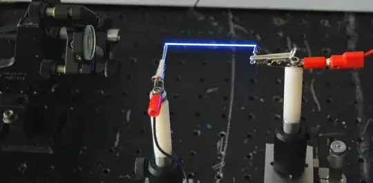

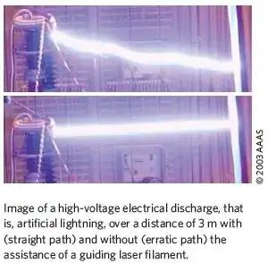

Laser induced electrical discharge. enter image description here

My impression is that the laser beam creates a long thin cylindrical zone inside which the atoms are ionized, allowing electrical discharges along the cylinder - along the interior of that cylindrical zone - to happen.
So it must depend on how fast those discharges are. Can they get to the other side - the end of the cylinder, the E-Fan that you want to power - before the air flow of the wind carries the ionized atoms out of the cylindrical zone of ionization created by the laser beam, and into an environment where they will quickly capture free electrons and become neutral and non-conducting again.
