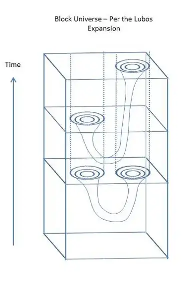

Edit 2: Re The Lubos Expansion
Lubos gives an example of a wormhole spacetime that appears to be a time-machine, and then offers four ways of getting rid of the prospective or resulting time machine for those who object in principle. Whilst I appreciate the difficulties with time-machines I am neither for nor against them per sunt, so I will concentrate on the creation issue. I have illustrated my interpretation of Lubos' description below. Block Universe Wormhole
As I understand it, there is nothing in GR that in principle prevents one from having a manifold in which two otherwise spacelike surfaces are connected in such a way as to permit some sort of time travel. This is the situation shown in the upper part of the illustration. The question is how can the situation in the upper part of the illustration be obtained from the situation in the lower part?

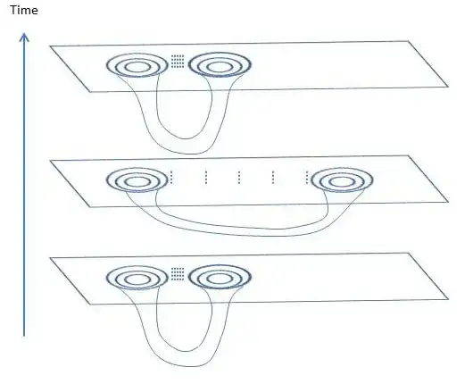

Now consider the illustration below of a spacelike surface with a simple wormhole (which I think is a valid foliation of e.g. a toroidal universe). As time passes, the two mouths move apart thanks to expansion of space between them, and then close up again by the inverse process (as indicated by the changing separation of the dotted lines, which remain stationary)
alt text

Expansion
Dear Julian,
I am afraid that you are trying to answer more detailed questions by classical general relativity than what it can answer. It is clearly possible to construct smooth spacetime manifolds such that a wormhole is connecting places X, Y whose time delay is small at the beginning but very large - and possibly, larger than the separation over $c$ - at the end. Just think about it.
You may cut two time-like-oriented solid cylinders from the Minkowski spacetime. Their disk-shaped bases in the past both occur at $t=0$ but their disked-shaped bases in the future appear at $t_1$ and $t_2$, respectively. I can easily take $c|t_1-t_2| > R$ where $R$ is the separation between the cylinders. Now, join the cylinders by a wormholes - a tube that goes in between them. In fact, I can make the wormhole's proper length decreasing as we go into the future. It seems pretty manifest that one may join these cylinders bya tube in such a way that the geometry will be locally smooth and Minkowski.
These manifolds are locally smooth and Minkowski, when it comes to their signature. You can calculate their Einstein's tensor - it will be a function of the manifold. If you allow any negative energy density etc. - and the very existence of wormholes more or less forces you to allow negative energy density - then you may simply postulate that there was an energy density and a stress-energy tensor that, when inserted to Einstein's equations, produced the particular geometry. So you can't possibly avoid the existence of spacetime geometries in which a wormhole produces a time machine sometime in the future just in classical general relativity without any constraints.
The only ways to avoid these - almost certainly pathological - configurations is to
  1. postulate that the spacetime may be sliced in such a way that all separations on the slice are spacelike (or light-like at most) - this clearly rules "time traveling" configurations pretty much from the start
  2. appreciate some kind of energy conditions that prohibits or the negative energy densities
  3. impose other restrictions on the stress-energy tensor, e.g. that it comes from some matter that satisfies some equations of motion with extra properties
  4. take some quantum mechanics - like Susskind - into account
If you don't do either, then wormholes will clearly be able to reconnect spacetime in any way they want. This statement boils down to the fact that the geometry where time-like links don't exist at the beginning but they do exist at the end may be constructed.
All the best Lubos
