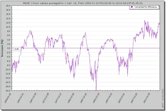

Looking at a flux vs. time graph of secondary cosmic rays (e.g. from a neutron station: www.nmdb.eu/nest/search.php can plot you some. I just tried for example Moscow, from 14 Oct 1951 to today, scaling options $\to$ Specify your own Y axis scale -20,20, left untouched all other options), it's easy to see a periodicity that fits well with the solar 11 - 22 year cycles.

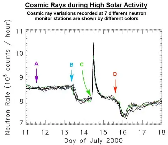

Here's an example of this, during two coronal mass ejections (CMEs), unrelated to the solar maxima:
A and C are when the Sun undergoes CMEs, and B and D are when particles from those CMEs reach Earth. Both lead to Forbush decreases, although the second is more dramatic, as is the spike preceding it (likely from SEPs).

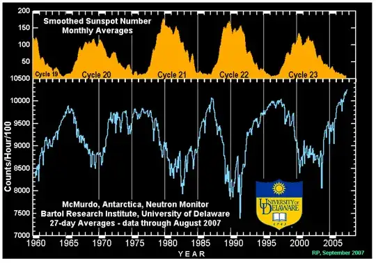

On a larger scale, of course, there is indeed a correlation between the solar cycle and cosmic ray detection:
This happens for much the same reasons as the Forbush decreases. The above chart, by the way, matches very well the observations recorded in the graph you specified:
