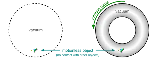

You seem to have asked multiple questions, and the answers to them are not all the same. So let's start with the physically observable ones, that we could in principle test to see what happens, before getting into any philosphical arguments about the "centrifugal force" and whether it really exists or not.
Will an object which you place inside the 'pipe' of the [vacuum-filled] torus […] be attracted to the edge of the torus?
No, it would not. With no contact between the object and the torus, they do not interact in any way,* and in particular, the torus cannot exert any force on the object. Thus, the object will behave in the same way (i.e. floating in place) regardless of whether the torus is actually there or not (and also whether, if present, it is spinning or not).
Illustration of a motionless object inside a rotating torus
*) I'm neglecting any gravitational and long-range electromagnetic interactions between the object and the torus here, as well as even more subtle effects like relativistic frame dragging. In principle, those could all transmit forces between the torus and the object, but in practice, assuming that neither the object nor the torus carry any significant electric charges or magnetization, those effects should be negligible.

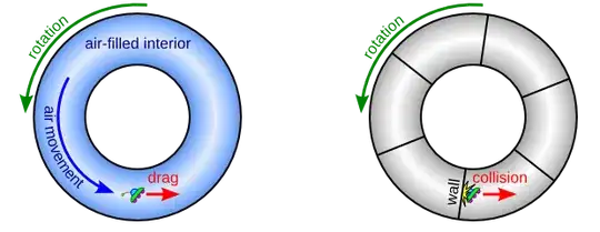

And would the results be different if the torus was filled with a gas (air)?
Yes, because, even if the air wasn't initially rotating, aerodynamic drag forces along the walls of the torus would eventually cause the air to start rotating together with the torus. Those same drag forces would also then cause the object to move along with the air, which would eventually bring it in contact with the outer wall of the torus.
(For more details, you may also want to take a look at this thread on Science Fiction Stack Exchange, which concerns the physics of a helicopter flying inside a rotating air-filled space station.)
And if the inside of the torus was divided into sections (like the ship)?
If interior of the torus was in vacuum, but had radial walls dividing it into sections, then there would initially be no force exerted on the floating object. However, since the object is stationary but the section walls are rotating with the torus, one of them would eventually hit the object, imparting some non-zero tangential velocity to it. Again, this velocity would eventually bring it into contact with the outer wall.
Illustration of an object inside a rotating torus with air or walls

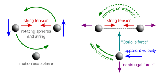

For a simpler example, consider two spheres floating in space near each other. If you do nothing, they'll just keep floating there. If you push each of them in different directions, then they'll each float in the direction you pushed them, away from each other. But if the spheres have been tied together with a string, then the tension of the string will exert a force that will curve their trajectories into circles:
Illustration of circular motion due to a centripetal force
Now, if we switch to a non-inertial frame of reference which is rotating along with the spheres (say, if we consider an observer sitting on one of the spheres and looking at the other) then they will look as it they were motionless. But clearly something is still pulling the string taut (and, if it's elastic, stretching it), counteracting the tension force that is pulling the spheres together. We call this apparent force (which is really just inertia, hidden by the fact that our coordinate system is rotating) the "centrifugal force":
Illustration of centripetal and centrifugal forces in a rotating coordinate system
But the centrifugal force is not the only fictitious force that we need to add in order to explain the movements of objects in a rotating coordinate system like this. For example, consider a third sphere, placed next to the two we already have, but just floating in space without moving anywhere. To an observer rotating along with the first two spheres, the third one will instead appear to be tracing a circular path around the rotation axis. To explain this apparent motion, while staying in the rotating coordinate system, we need to add yet another "fake" force that only applies to (seemingly) moving objects, called the Coriolis force:
Illustration of the Coriolis force in a rotating coordinate frame
Basically, what we call the centrifugal force is the adjustment we need to make to Newton's laws to account for the fact that our reference frame is rotating, and so objects that look stationary in it are actually moving in a circle, while the Coriolis force is the further correction needed to account for the fact that not everything actually rotates along with our reference frame. (If the rotational speed of our reference frame was actually changing, we'd also need to add in an Euler force as a further correction.)
So, to answer your literal question, it depends on how we look at the system. If we look at your rotating torus and floating object in a non-rotating reference frame, then there is no such thing as a centrifugal force, and thus, of course, such a nonexistent force cannot affect your object in any way. The object simply remains motionless because there are no forces acting on it.
