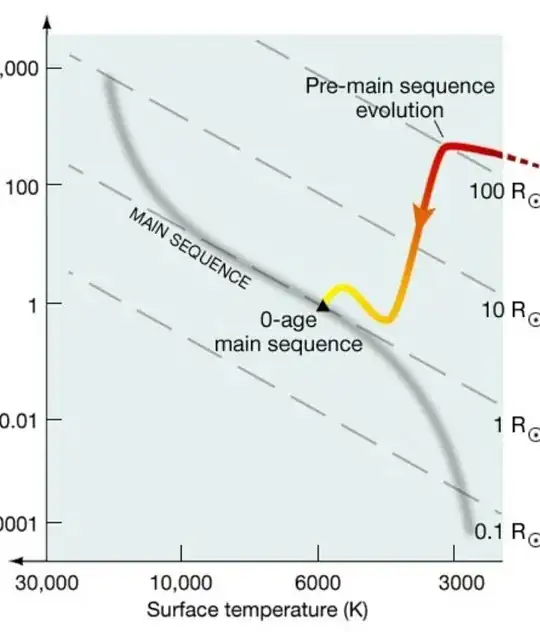

Why is a pre-main sequence star brighter than it will be when it reaches the main sequence?
ProfRob
  • 141,325
It is not generally true that a Pre-Main Sequence (PMS) star is brighter than the corresponding Zero-Age Main Sequence (ZAMS) star - whether this is the case depends on the mass. The main source of energy in this phase is the gravitational potential energy of the gas cloud being converted into random kinetic, i.e. thermal, energy. The main question is how fast this energy is transported out of the protostar, compared to how fast the star is contracting and the temperature rising.
The figure in the question shows, correctly, an evolutionary track in the H-R diagram of a PMS object. However, this track is only valid for a certain mass.

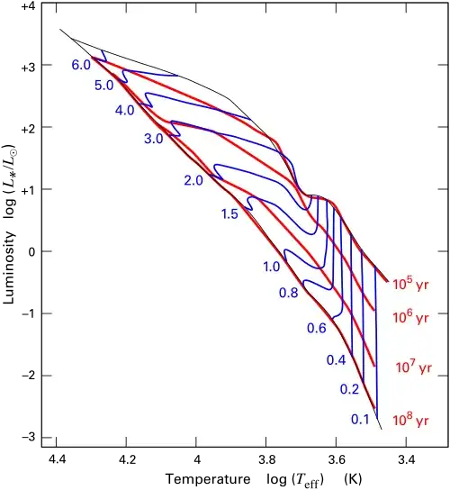

The figure above, from the Wikipedia Hayashi Track entry, shows representative PMS evolutionary tracks for different masses. The blue lines are tracks through the H-R diagram for PMS objects of different masses; they start on the upper diagonal, called the birth line (the time when the surrounding clouds get cleared away and the system becomes visible), and end on the lower black diagonal, the Zero Age Main Sequence (the time when Hydrogen fusion sets in). The blue numbers below the ZAMS show the final mass of the star in Solar masses. The red lines show isochrones; where the different evolutionary tracks crosses the same isochrone, the corresponding objects have the same age. You can see that a $6.0 M_{\odot}$ star reaches the ZAMS after only a hundred thousand years, a time when a $0.1 M_{\odot}$ star has not left the birthline yet. It takes 10 million years for a $2.0 M_{\odot}$ star and 100 million years for stars of $M \lesssim 1.5 M_{\odot}$ to reach the ZAMS.
The almost-vertical parts of the tracks are called Hayashi tracks. In this phase, the contraction happens more or less isothermally. The objects on these stages are convective, such that the heat generated by contraction is transported from the core to the outer layers efficiently enough that the object stays roughly at the same temperature. Therefore, its surface brightness also stays unchanged, and the luminosity simply scales with the surface area.
For higher mass systems, however, the contraction happens too fast, the temperature in the core becomes so hot that a radiative zone develops, and convection becomes inefficient and surplus energy is trapped in the system. As it contracts, the temperature therefore rises steeply, and the surface brightness rises with it. This is partly or completely cancelled by the shrinking surface area, meaning that the total luminosity stays roughly unchanged or growing slightly, but the temperature rises steeply. This is seen as a more or less horizontal track going right-to-left in the diagram; these are called Heyney Tracks
As the figure shows, intermediate mass systems are relatively cool in the beginning, allowing for convection, so they start on the Hayashi Track, but as the temperature gets larger, convection is broken, and it turns onto a Heyney track as the heat cannot escape efficiently anymore.

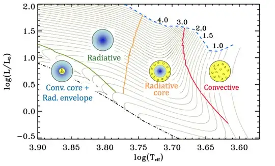

EDIT: i found this figure from this publication which shows some more detail.
Here, the isochrones are gone, but the diagram is separated into regions corresponding to four different scenarios: Fully convective, fully radiative, Radiative core with convective outer layers, and convective core with radiative outer layers. All stars with $M \leq 3.5 M_{\odot}$ go through some phase with a convective core. All stars of $M \geq 1.5 M_{\odot}$ go through several phases, from possibly being fully convective, over having a radiative core and convective outer layers, over being fully radiative, to developing a convective core and radiative outer layers, before settling on the ZAMS.
