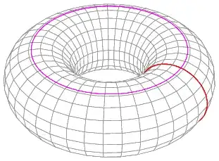

Or, for another example, consider a torus. There are some one-dimensional, string loops on the torus you can bring to a point (aka "null-homotopic closed paths"), but there are some you can't. For instance, any one of these loops cannot be brought to a point:
Not alone are you unable to bring these loops together, you can't even deform the red one to become the purple one. Those are two distinct 1-dimensional holes in our space/manifold, so the 1-D homology (or cohomology) is going to have two independent generators in this situation.
Any shape inside the space is a hole if it has no boundary or it is not the boundary of anything else.
