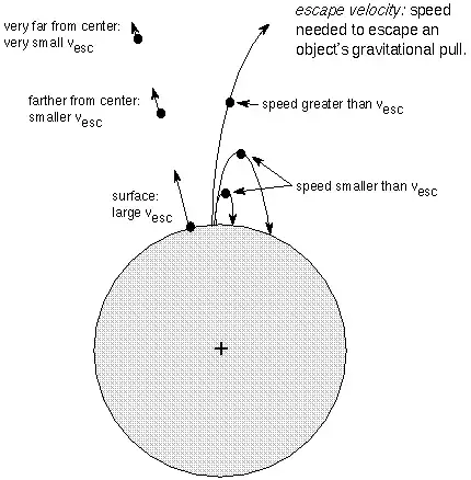

Let's first calculate escape velocity equation, First let's look at the amount of work $dW$ needed to move an object over a distance $dr$.

This is the work needed for an object to reach an escape velocity, Now we can make this equal to kinetic energy $K_e$ which will be minimum amount of energy required for an object to reach escape velocity, So we Need $W=K_e$
$$\frac{mv_{escape}^2}{2}=\frac{GMm}{r} \Rightarrow v_{escape}^2=2\frac{Gm}{r}$$
$$v_{escape}=\sqrt{\frac{2GM}{r}}$$

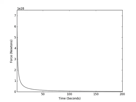

Now we can graph this function where $t$ will be a variable thus we can get an idea of a force required to apply on Earth at a given interval of time, So that it will reach escape velocity in time $t$.
$10^{28} Newtons$ is a enormous amount of force and no everyday object can ever be able to exert such a force on earth. According to Live Science a human can exert a "maximum" force of $5000 Newtons$, Lets imagine that a person can somehow exert this force on earth continuously, given this we can now calculate how much time it will take for earth to reach escape velocity:
$$5000 = \frac{7.1664 \times 10^{28}}{t}$$
$$t = \frac{7.1664 \times 10^{28}}{5000} \Rightarrow t = 1.43328 \times 10^{25} seconds$$
$$t = 4.5 \times 10^{17} years$$
Which is way larger than the age of the universe itself, About $32,912,227$ times larger to be precise, Therefore we can conclude that a human being cannot accelerate earth to escape velocity from sun in a reasonable amount of time, Even if such a thing was attempted by human beings on Earth, it still wouldn't work because the sun has about 5 billion years to go before becoming a red giant and "swallowing" the Earth.
