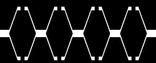

A cheap baffle box can be made out of egg create foams. cutting a hole on them and placing on the open window can pass air but it reduces sound. You can add more or glue a flipped one to have more sound reduction.
acoustic base
Without the vertically flipped one, it is easier to pass sound from your room/house out.
