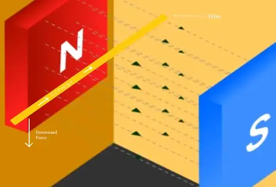

What exactly is happening to the electrons inside the wire while it is moving quickly downwards within the magnetic field?
Why do electrons move in one direction if the wire is being pushed down?
I don't care what direction electrons move. I want to know why they move in one direction?
DanielSank
  • 25,766
The primary reason for the movement of electrons is because of the Lorentz force given by F = q.v x B Now, this force is primarily acting because of the velocity of the electron and an external magnetic field acting on it. You may think why is magnetic field applying a force on an electrical charge? The reason is simple and elegant (took many years to realise and to further mathematically express and document the relations). Force in a static frame of reference (relative to the electron) will be solely due to an electric field, but when the electron is moving with respect to our frame, the electric field has to translate into a magnetic field, which is evident in the Lorentz force equation. Thus, an electric field due to the electron at rest will translate into a magnetic field in motion. But this is due to the electron, and of course, the electron will not experience a force because of the fields it itself produces, but this does give you an intuition that what an electric field is in a static situation is same as a magnetic field in a dynamic situation, thus both applying the same force. So, in your question, the field is from the left to right, while the velocity is downwards. Thus according to the cross product (keeping in mind the negative charge of the electron), a force will act in the forward direction on the electrons. Therefore, the front facing side of the wire will be having a positive potential with respect to the farther side.

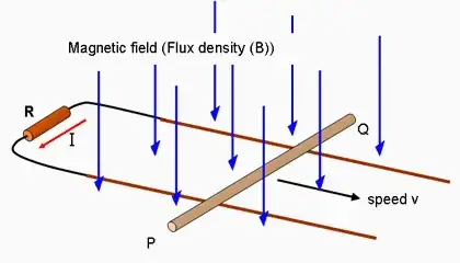

When the magnetic flux through the wire changes, as it moves down, Faraday's law of induction says that it acquires an electromotive force.
The induced electromotive force in any closed circuit is equal to the rate of change of the magnetic flux enclosed by the circuit:
$${{\mathcal {E}}=-{{\mathrm d\Phi _{\mathbf {B} }} \over\mathrm dt}\ }$$
where ${ {\mathcal {E}}}$ is the $\rm EMF$ and $\Phi_{\mathbf B}$ is the magnetic flux.
Why do electrons move in one direction if the wire is being push down? I don't care what direction electrons move... I want to know WHY they move in one direction?
The EMF will now cause a current to flow in the external resistor R. This means that a similar current (electron flow) flows through the rod PQ itself, giving a magnetic force to the left.
If you read the above, and remembering that the direction of the electromotive force is given by Lenz's law,  which states that an induced current (the electrons) will flow in the direction that will oppose the change which produced it.
The flow of current is nothing but movement of electrons when a potential difference is applied across the ends of a conductor(in your case a wire). Electrons flow towards positive terminal and create a magnetic field around a wire. This magnetic field will cancel any other magnetic field that is of lesser or equal magnitude, which is why electrons being unaffected will keep moving along in the same direction.
