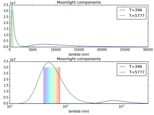

With this assumption, we can use Planck's Law to calculate the apparent "brightness spectrum" of the moon's surface due to black body emission (because the moon is warm) and due to the partial reflection of sunlight. I wrote a little Python program to calculate this, and plotted a graph of the result (note - the upper plot shows a linear wavelength axis; from this you get the sense that the sunlight is bright, but in a narrow range of wavelengths; the lower plot uses a logarithmic axis: this better lets you see the shape of the curves, but you lose your ability to "integrate by eye").
Integrating these two curves, I got the remarkable result that the areas under the two curves (the power due to the reflected sunlight, and the moon's black body radiation) are almost identical (ratio moon/sun = 0.97). I think that's a coincidence. If the moon did not rotate, I would expect it to continue to warm up further (note that the moon, being a sphere, will not be uniformly at 123 C on the sunny side: it will be hotter on the parts that face the sun directly, and hotter again in those parts that were in the sunlight longer; the assumption here that the moon looks like a uniform disk is a significant simplification which may lead to errors of 50% or so - but since 123 C is the given maximum, I think at best this overestimates the temperature that can be reached; unless you could focus your mirror/lens system on just the hottest part of the moon, you would be looking at a "colder" surface, and this would reduce the temperature you could reach).

So we get roughly equal amounts of energy from the reflected sunlight, and from the moon's heat. This means that the total energy density of the moon is like that of an object that is slightly hotter than the 123 C value used - in fact, and object with that power density would have to be at a temperature of $\sqrt[4]{2}*(123+273)-273=198°C$.
Now an optical system that manages to image the moon in such a way that it illuminates all sides of the target (in effect, making it appear to the target that it is surrounded on all sides by that object - at which point it will end up in thermal equilibrium with that object) can heat that target to the temperature of the object being heated.
Which makes the answer to your question 198°C. This is higher than the temperature of the moon's surface because of the reflected sunlight component which has the same spectral power. This argument does not account for absorption of certain parts of the spectrum by the atmophere; also, it seems to contradict the calculation in this what-if which basically claims (without calculation) that the component of reflected sunlight does not play a role.
