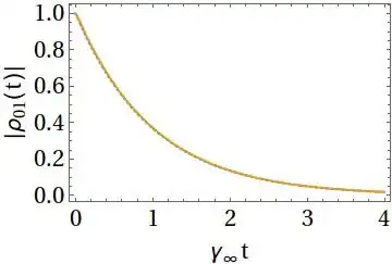

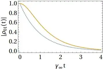

The plots below show the exact evolution of (the absolute value of) the qubit coherence for two examples, with the Markov approximation included for comparison (dotted line). The first plot shows $\Omega = 2\gamma_\infty$, where the transient dynamics differs significantly from the simple Markov result. The second plot shows $\Omega = 100\gamma_\infty$, in which case the noise memory time is negligibly short and the Markov approximation is accurate for all practical purposes. Note, however, that there always exists a time regime $t\ll \Omega^{-1}$ where the dynamics is non-Markovian. Nevertheless, whenever the Markov assumption $\gamma_\infty\ll \Omega$ holds, the system barely evolves over such a short time and thus the non-Markovian aspects of the evolution are not seen.

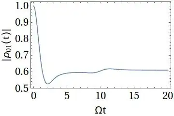

Just for fun, here's a more complex example. Consider the following spectral density $$ S(\omega) = \frac{\alpha}{\Omega^2} \omega^3 \left[ 1 - \mathrm{sinc}\left( \frac{\omega}{\varpi}\right) \right] \ee^{-\omega^2/(2\Omega^2)}.$$ Such a spectral density can be realised with a qubit comprising two localised states of an atom in a double-well potential. If this atom is plunged into a cold bosonic gas forming a Bose-Einstein condensate, it decoheres by scattering atoms in the condensate and thus generating phonons. In particular, if the impurity atom (i.e. the one forming the qubit) is prepared in a delocalised state, i.e. a coherent superposition of being localised in the left well ($\lvert 0\rangle$) and the right well ($\lvert 1\rangle$), over time this coherence vanishes. The coupling $\alpha$ is proportional to the scattering cross-section for impurity-gas collisions, while $\Omega = c/\ell$ and $\varpi = c/L$, where $\ell$ is the width of the wave functions describing the localised states, $L$ is the separation between the double-well minima, and $c$ is the speed of sound in the gas. More details can be found in, for example, one of our papers here.
See below for a plot of the decoherence dynamics, for $\alpha = 1$ and $\Omega = 10\varpi$. Interestingly, the coherence does not asymptotically vanish, but reaches a constant, finite value. Even more interestingly, there are two periods where lost coherence is regained, i.e. the decoherence rate is negative, a signature of truly non-Markovian dynamics.
The second recoherence phase (occurring at $\Omega t = 10$) has a particularly pleasing physical interpretation: it always occurs at a time $t = \varpi^{-1} = L/c$, which is the time taken for the disturbance in the superfluid generated at one potential minimum to propagate to the other one. Thus some of the lost coherence is regained due to the fact that both localised states interact with a common superfluid reservoir. However, this only comes into effect after some time delay due to the finite speed of signal propagation in the superfluid.
