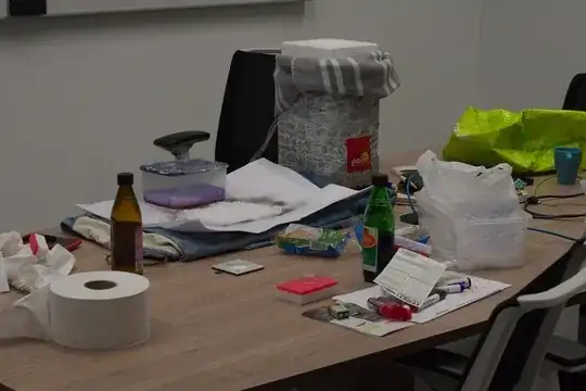

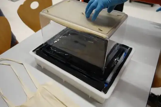

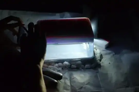

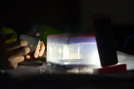

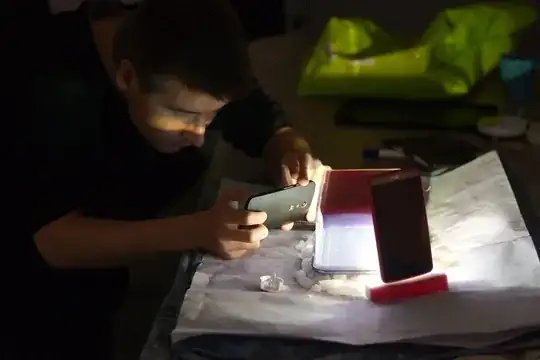

My setup:
  • plastic box (~1l) with the cover painted black mat
  • the bottom of the box covered with sponges saturated with ethyl alcohol (90%) to the limit (all over sponge capacity poured back to bottle)
  • turned upside down and placed on ~0.5kg of dry ice.
I can see a 'rain' of particles of alcohol, but no traces.
I disassembled smoke detector and attached the sample of americium to the box. No effect.
Here is the 'rain': http://youtu.be/DhnO3e2H724?t=123
Here are some pictures of the setup:
Any help appreciated.
